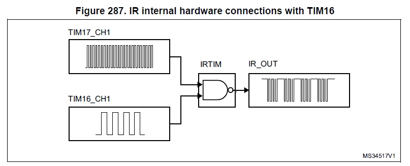

Hello.
I studied the
http://www.st.com/content/ccc/resource/technical/document/application_note/group0/36/b5/60/26/50/c7/46/4a/DM00271524/files/DM00271524.pdf/jcr:content/translations/en.DM00271524.pdf
''Implementation of transmitters and receivers for infrared remote control protocols with STM32Cube'' and I reproduced the application
http://www.st.com/content/st_com/en/products/embedded-software/mcus-embedded-software/stm32-embedded-software/stm32cube-expansion-software/x-cube-irremote.html
on a NUCLEO-F303RE.
I know the required interface IRTIM is only available on STM32F0, STM32F3 and STM32L4 series, but I need to implement the infrared transmitter on STM32F7.
I don't understand how this IRTIM works. I only know that It uses internal connections between TIM16 and TIM17 to generate the infrared remote control signals. How can I replicate this application on my F7 microcontroller?

    Modulate the PWM values being programmed into the TIM from update to update, from a pattern table, using DMA, for example. Or from an Update IRQ if you prefer.

    Do you know why they configure TIM17 channel 1 and TIM16 channel 1 as Output Compare in the example? Why didn't they set the channels as PWM? Is it because of IRTIM?
    What is the difference between OC and PWM to generate a waveform?

    PWM is one of the OC MODEs, ie rising edge at zero, trailing edge a CCR1 trigger point, TIMING is another mode, it is not about a pulse width but rather a phase triggering point defined by CCR1
    Output signals to a pin and scope them?
