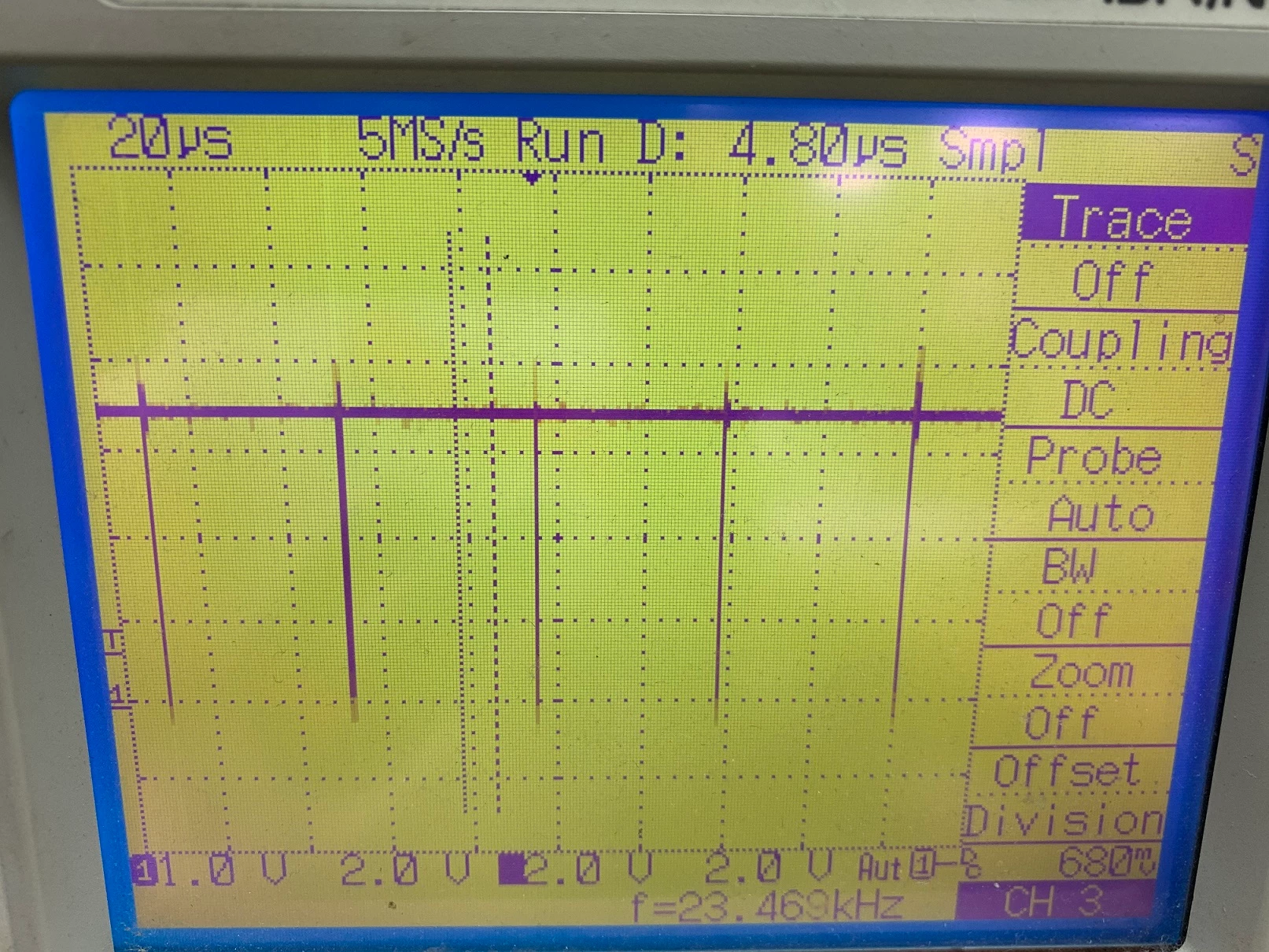

I tried to modify the example code X-CUBE-PWM-DITHR, I do not understand why aDitherTable recalculate the table of values max is 2047.
Please look the image of the oscilloscope on duty cycle 2047.
AN4507 Page 6 say
PWM-Effective_Resolution = PWM-Resolution + PWM-Dither_Resolution =11+1=12 bits=4095.
Therefore, from my understanding, duty cycle max should 4095.
bellow are the parts of the example code which were modified
Because the table contains values to be loaded into TIMx_CCRx, so they can't be higher than TIMx_ARR.
Maybe you should reconsider why would you need to use dithering at all, simply using TIMx_ARR=4095 and coping with the resulting lower PWM frequency.
