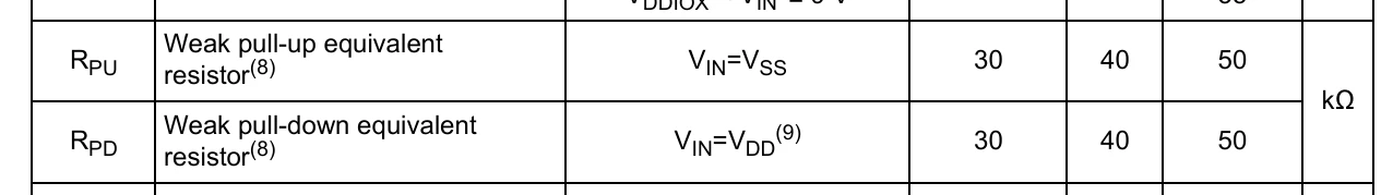

1. In order to calculate the values of pull up & pull down resistor, in which section can we find the impedance information?

1) In the datasheet under "I/O port characteristics". It's about 40 kOhm.
https://www.st.com/resource/en/datasheet/stm32h743bi.pdf
