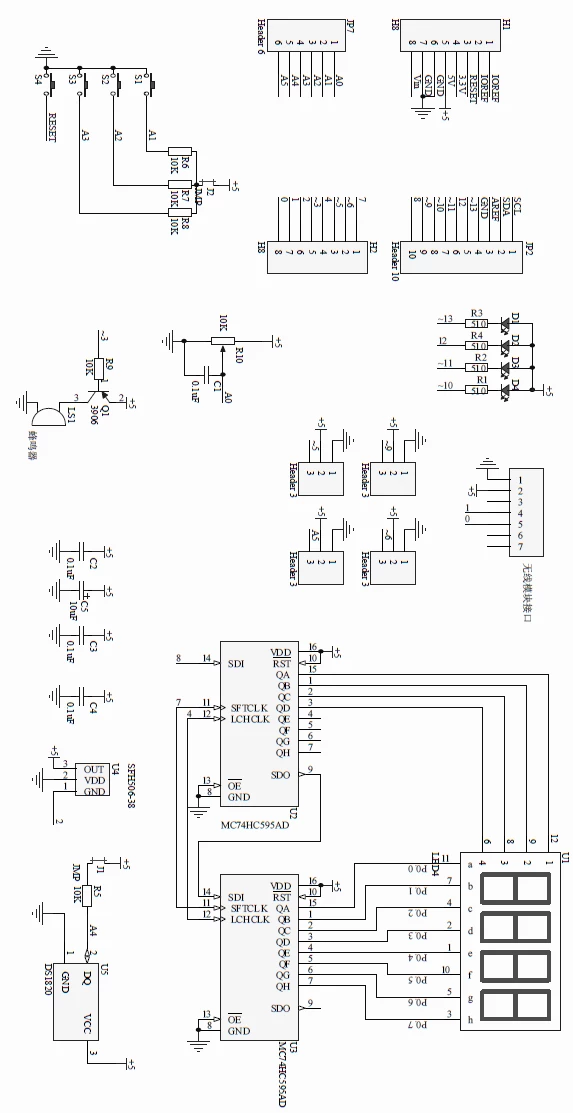

Im trying to control the Arduino Multifunction Shield by using stm32l053r8t6. What is the coding for the 4-digits 7segment on the multi function shield?
  • May 7, 2023
  • 4 replies
  • 3060 views
Im only can display the 7segment by using "sortSegment (numbers);" and it only display at 4th 7segment. How can i select which 7segment i want to display, and how can i display Characters?

Check the schematics of your board - you will see the connections.

You have to shift in 4 digits
D8=data, D7=clk, D4=latch

_legacyfs_online_stmicro_images_0693W00000bk0XeQAI.png this is the schematics of my Arduino Multifunction shield, and i just connect it to my stm32l053r8t6. Can someone teach me how to display my 7segment? Im already set the pin (PB5, PA8, PA9) to the gpio_output. Now i can only display numeric numbers, how to display characters?
BTan.5
BTan.5Author
May 13, 2023
Please teach me how to display characters and how to select which 7segment to display. Im already include the .c and .h files and i cannot understand it because im new to stm32:loudly_crying_face:

But are the conceptual issues here STM32 related?
You've got a 16-bit shift register, one half is uses to select the digit to be selected, and the other half the 7-segments to illuminate.
You keep an MCU side buffer, and cycle thru the digits continuously, frequently enough for the scan/persistence to work.
Shift registers are a basic concept. You drive a bit, clock it into the chain, and then there's a latch to move the shifting register into a holding register.
Make sure you've properly initialized the GPIO pins.
If you have a scope or logic analyzer perhaps use those to confirm or review your understanding.
