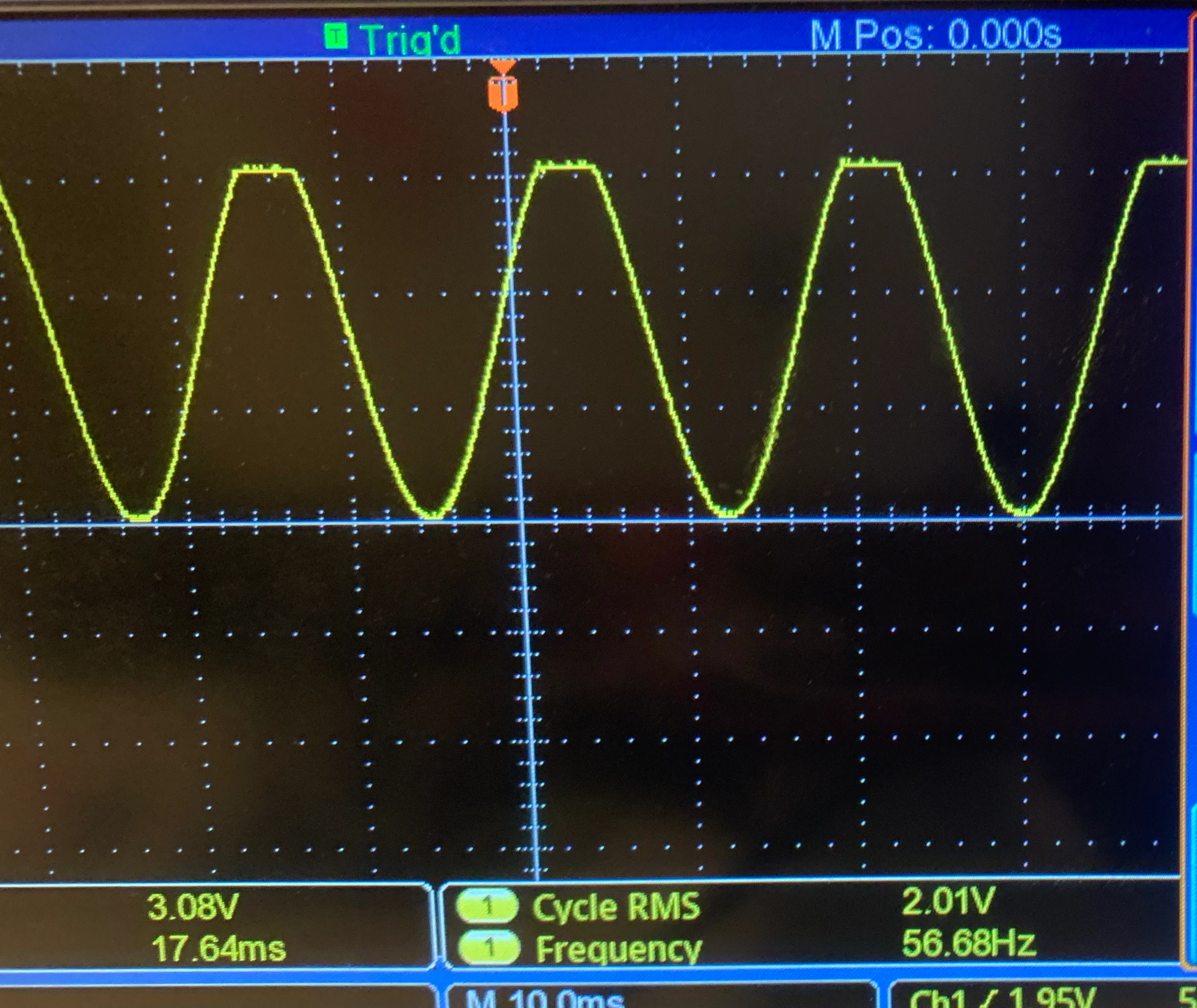

If I try to make a sine wave from my DAC channel, it seems like the top par of the sine wave gets cut off. I'm using 12 bit resolution and I don't go over the maximum(4095).

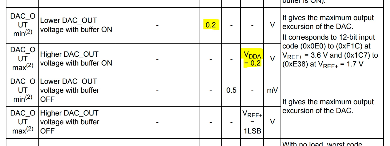

The output of the DAC with the output buffer enabled is not rail to rail.
