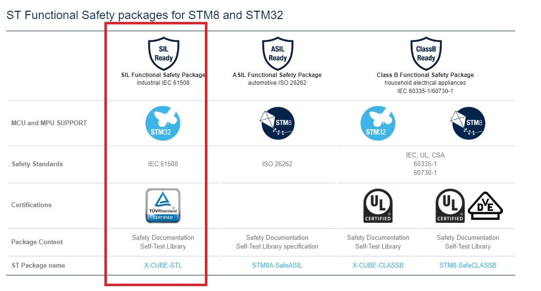

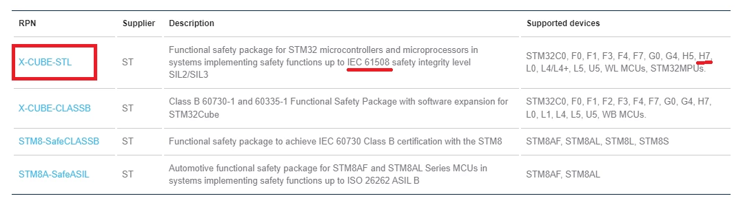

I am currently working on a medical device of safety class C that requires functional safety compliance, specifically adhering to IEC 61508 standards. We are considering using the STM32H723 series MCUs for our safety-critical application and would like to confirm if this series has been pre-certified for IEC 61508 compliance.
Could you kindly provide the following information:
  1. Functional Safety Certification: Are the STM32H723 MCUs SIL (Safety Integrity Level) certified under IEC 61508?
  2. Safety Manuals & Documentation: Is there any available functional safety package or certification documentation that you could share?
  3. Development Tools: Do the development tools and libraries for the STM32H723 support functional safety compliance under IEC 61508?
  4. Support for Diagnostics: Does this MCU series provide any built-in diagnostic features such as ECC memory, lockstep cores, or self-test routines that would aid in achieving compliance?
Our use case involves developing a safety-critical medical device, so having reliable safety documentation and certified toolchains is essential for us to meet the required functional safety standards.
Thank you for your assistance, and I look forward to your response.
mƎALLEm
mƎALLEmBest answer
September 19, 2024
Hello @STm32_Developer and welcome to the community,
Please have a look at this link: https://www.st.com/content/st_com/en/ecosystems/functionalsafety.html
