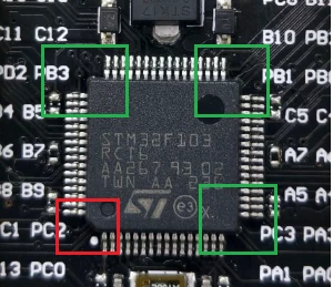

Hi @mƎALLEm  ,
just about your "not genuine" statement:
>- No "ARM " marking
Same here on a F103 by STM , should be genuine, because its st-link on a F3-discovery board !
>- There is a notch and a hole-like on one of the corners.
Exactly same "problem" for many users, using the chip in a rotated position, because they took the "big" point as pin 1 indication. Exactly this is on many H743ZI and H7A3Z chips , we have here.
Same on the F303 on the disco board, also " a notch and a hole-like on one " in the cornes.
So maybe all these are "fakes", also on the discovery board i have here, or
you take a little time and look at the products of the company you working at.
Then decide, what is fake or genuine...

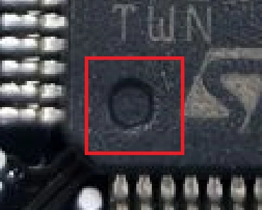

mƎALLEm
April 2, 2025
@AScha.3 wrote:
Hi @mƎALLEm  ,
hole-like -> the circle looks like a hole and deeper than it should be. Nothing to do with STM32 packages:
No "ARM" but at least a QR code (already mentioned before)
In any case we don't support these Blue/Black pill boards as , by history & experience, don't feature a genuine STM32.

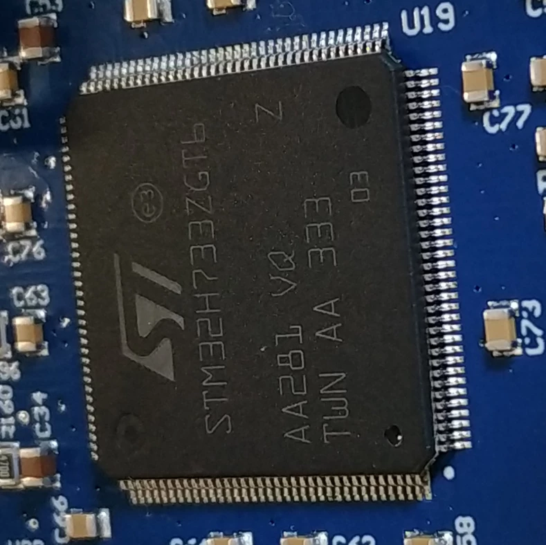

@mƎALLEm  ,
so just a pic from one of the boards i just see around here in office:
has:
- no ARM logo (and for sure is big enough, LQFP144 )
- deep small hole , at pin 1; even 2 (!) others, a flat big and a flat, with extra plateau in center.
+ made in TWN , obviously.
Now: fake or not ???

Here we are talking about STM32F1. You can open a new thread for this picture F4. <-- split to separate thread
Each product has its own marking and it's continuously changing.
@AScha.3 wrote:
- deep small hole
Not the same hole. The one he shared has a hole with a prominent cylinder from the bottom.
For the picture he shared I'm 99.99% it's fake.
Look at the the corners of the chip image he shared it has a notch in the bottom left of the corner. STM32 doesn't have a such particular "cut" in the corner.
And we know that STM32F1 was the most one targeted by the counterfeit.
