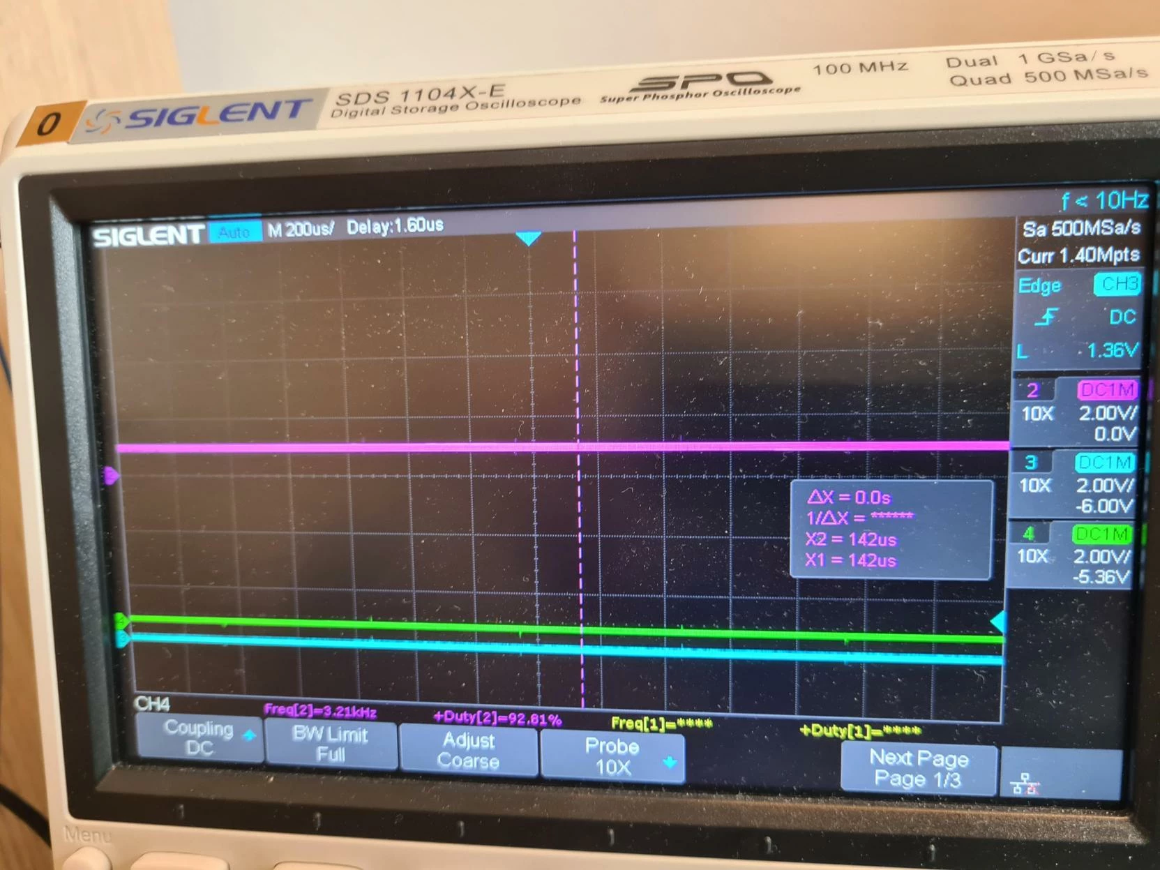

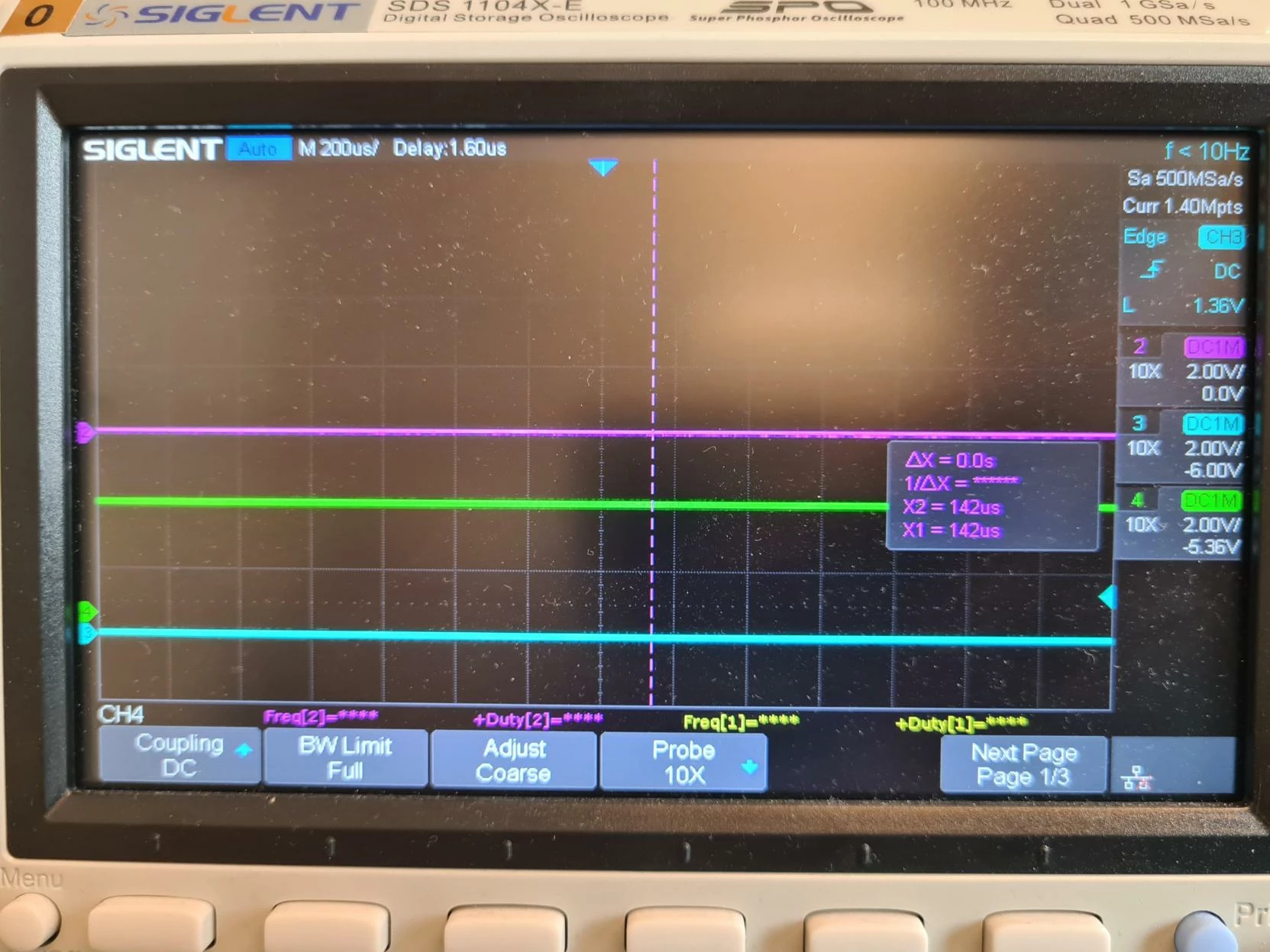

Hi!
The PWM signals are identical and work as  normal except when HAL_TIM_PWM_Stop (or HAL_TIM_PWM_Start) is called at duty 0. The Advanced timer work as expected and cause the output PWM to go low, while both PWM signals go low for the General timer.
I've tried reading the RM0440 Reference manual sections "28 Advanced-control timers (TIM1/TIM8/TIM20)" and "30 General purpose timers (TIM15/TIM16/TIM17)", but has found no clear cause of this.
Below are both my configurations and Oscilloskop output for both control signals and output PWM
Advacned timerTIM8 configuration

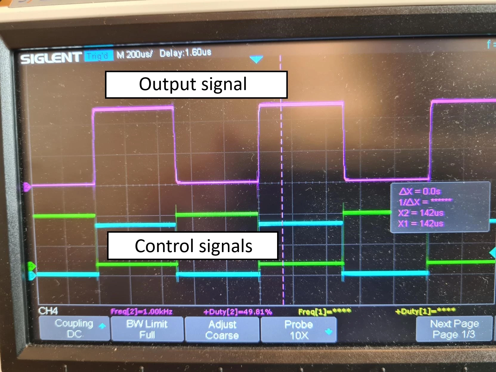

This is both PWM signals at 50% duty, and work as intended
This is the Advanced timer at 0% duty, and as expected the output is now 0 with 1 signals hight and 1 low
This is the General timer at duty 0%

waclawek.jan
September 9, 2024
On those pictures, green and blue are the two complementary outputs, correct? And what is the purple one?
Read out and compare/post TIM registers content for the two timers (and perhaps also the relevant GPIO registers content).
filvasAuthor
September 9, 2024
The purple one is an output controlled by the two complementary outputs depending on their duty.
