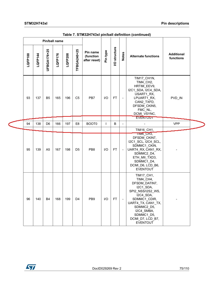

ICP/ICSP pin is located at which port number of STM32H753ZI MCU?

I referred the App Note AP2606, but i didn't get the information required. I would like to know, the pin details where exactly the ISP pin is located in STM32H753ZI MCU?

We still don't know what exactly do you mean by ISP.
STM32 can be programmed either using the debug interface - SWD or JTAG - or through bootloader. For former, review the Debug infrastructure chapter in Reference Manual (RM); for latter, refer to AN2606.

In-System Programming (ISP) and In-Application Programming (IAP) via on-chip boot loader software. To set forcefully in to boot loading mode through hardware, where can i found this pin in pin details of STM32H753ZI MCU?
waclawek.jan
waclawek.janBest answer
September 10, 2019
From the datasheet (this is for 'H743, look into datasheet of your mcu, it will be the same):0690X00000AQwq7QAD.png

Thank you so much.
