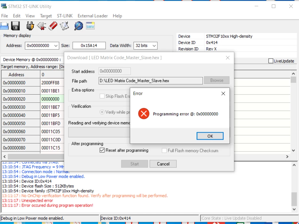

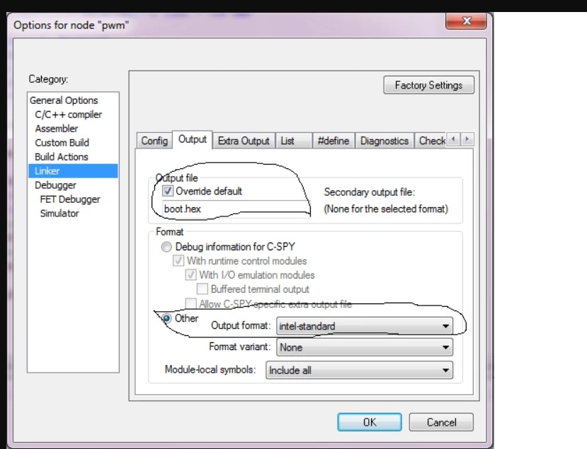

Hi
I have generated intel binary file using iar 6.2 version for stm32f103vet6 but while flashing the same error occurs
what can be issue for programming error@0x00000000

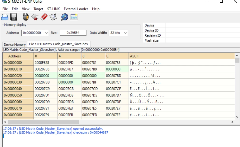

That you're build code to reside at 0x00000000 and not 0x08000000 ?
Check your Linker Script or .ICF settings, check the .MAP to see what the Linker is building, dump the .ELF to see what was generated there, or load the .HEX in a text editor an check that. Should have one of the first couple of lines indicate the right memory segment/offset to start with.

initial address 0x00000000 in hex file 2000FE28 000294FD 00020781
