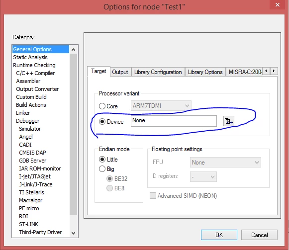

Hello everybody!
I am trying to work with stm32h743ZI with IAR V7.70.1, While trying to configure IAR settings 'options' I can't find (at options > General otions) STM32H7 with the target processor devices from ST
Is there any package I need to install to allow me to choose the right chip I am using? or any other solution?
Thanks in Advance.

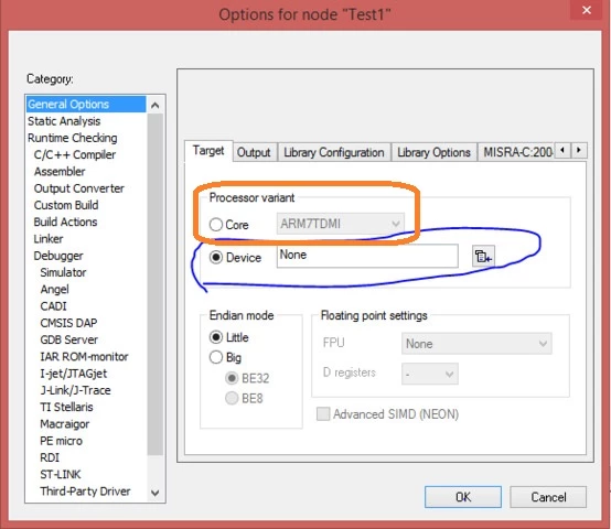

Tesla DeLorean
Guru
March 6, 2019
Can you select "Cortex-M7" as a Core?

Hi @Moamen Ayman​ ,
The STM32H7 devices are not supported by IAR Embedded Workbench for ARM toolchain V7.70.1.
Please use version V7.80.4.

Moamen Ayman
September 19, 2018
Thanks @Khouloud GARSI​  I will download this version  V7.80.4 or higher.
Moamen Ayman
September 19, 2018
@Khouloud GARSI​  I searched the supported devices in this version V7.80.4 but it's STM32H7 controllers are not supported!!

Hi @Moamen Ayman​ ,
You're right, the AR Embedded Workbench for ARM toolchain has started supporting STM32H7x3 devices starting from version V8.11.1 .
Sorry for any encountered inconvenience!

Hello everybody,
I encountered a similar problem. But my situation is a little different. I have a license for "7.70" and I have to use this license.
Is there any method?
Tesla DeLorean
Guru
March 6, 2019
Does it support Cortex-M7? Find a close proxy and use that, and adapt the memory map.
STM32Cube_FW_H7_V1.3.0\Utilities\PC_Software\patch\EWARM\EWARM_v7_STM32H750xx_Support.zip
