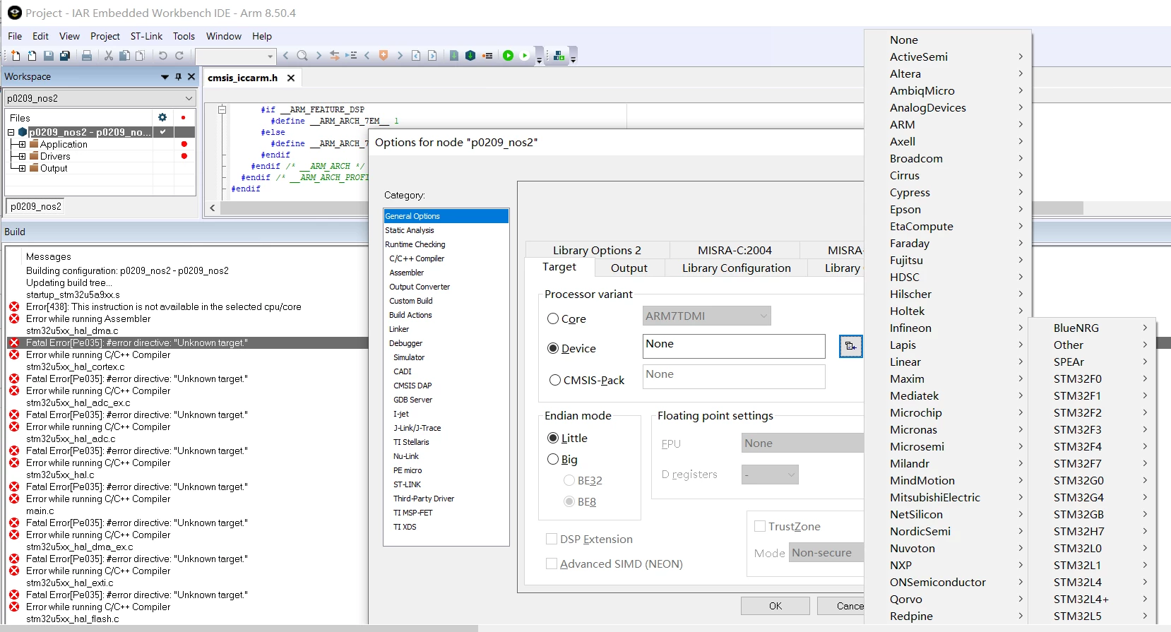

IAR 8.50.4 does not contain STM32U5A9.
As in picture above, STM32U5A9 can not be found in device catagory of IAR 8.50.4,how to config it?
thank you.

Check for patches in the Utilities directories of your Cube Packages/Repos
https://github.com/STMicroelectronics/STM32CubeU5/tree/main/Utilities/PC_Software/IDEs_Patches/EWARM
