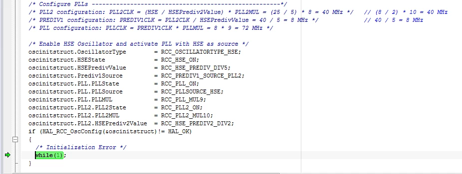

    Now I am using STM32F103RE that has 64k ram. But when I configure its clock, debugger gets struct in while loop at
    if (HAL_RCC_OscConfig(&oscinitstruct)!= HAL_OK)
    /* Initialization Error */
    while(1);
    Please check the following modification for 8 MHz HSE. Am I doing it wrong?

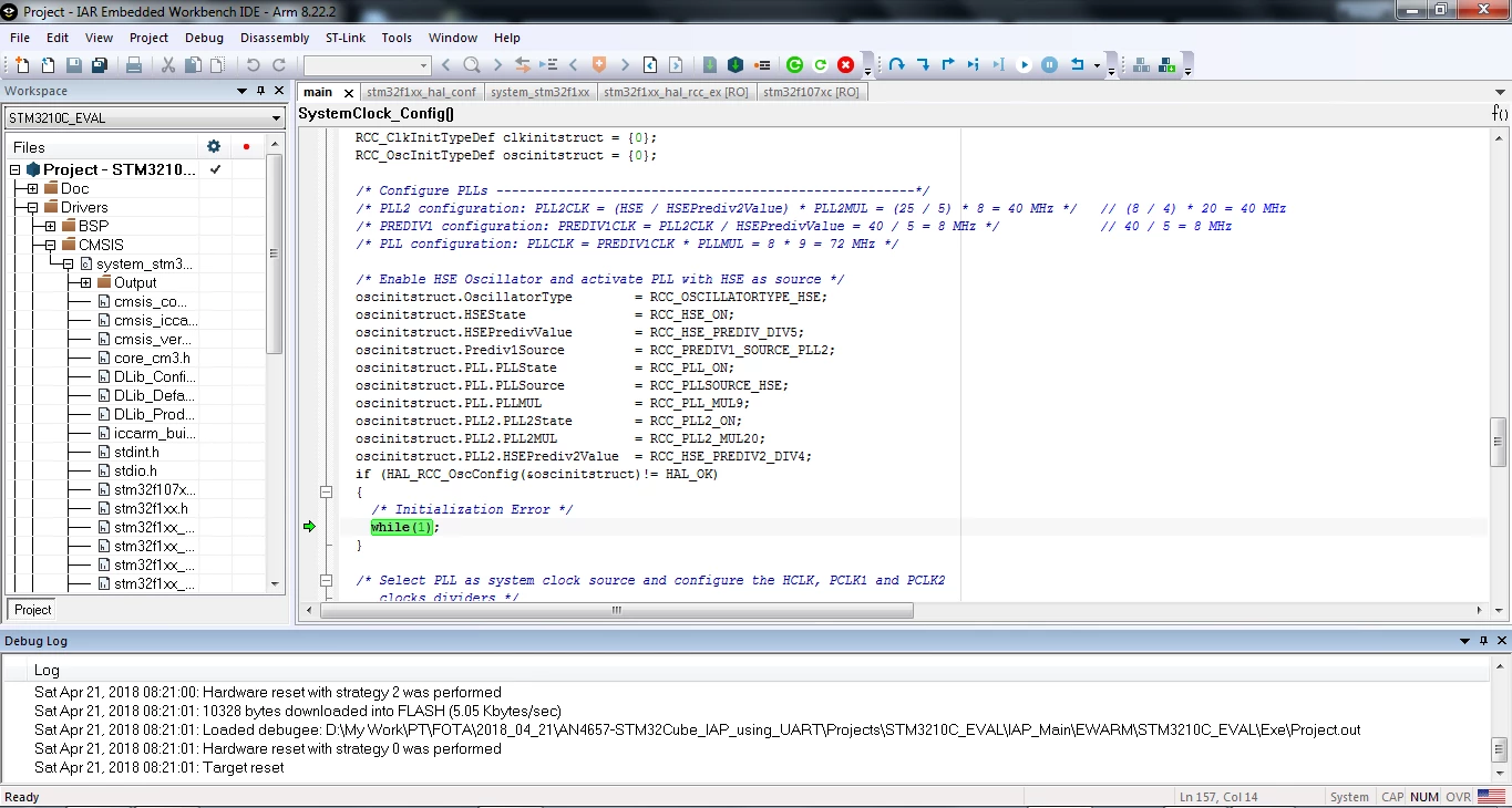

    Even it is getting struct with following configuration as well
    I am using following IAP example
    .\AN4657-STM32Cube_IAP_using_UART\Projects\STM3210C_EVAL\IAP_Main\EWARM\STM3210C_EVAL\
    Tesla DeLorean
    Guru
    Apr 21, 2018 5:22 PM UTC
    Posted on April 21, 2018 at 17:22
    Suggests the HSE clock isn't starting properly, or there is a parameter error. You'd want to single step into the code, or use the RCC registers directly to bring up the clocks, and validate with a scope. The clock can also be configured to output via the PA8 (MCO) pin.
    You might want to start with using the HSI, and clocking up to 64 MHz via the PLL. Once you get to main() enable the HSE_ON bit in the RCC register.
