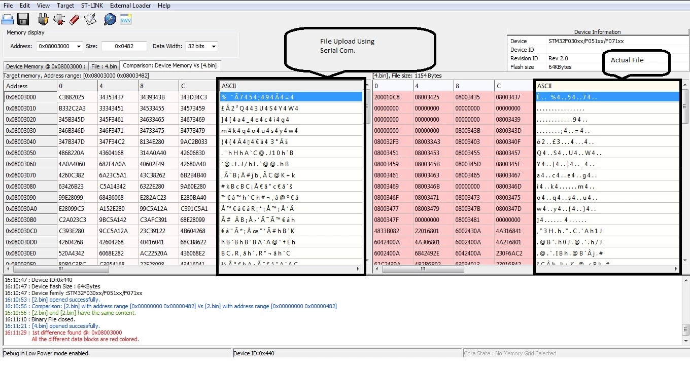

Hi, Clive1
Here is a attachment in which you can see I am able to receive complete new file from the terminal with no error. I have received .bin file of 28 kb
(size on HDD)
That means in a single controller there will be two file when OTA update function is called.
Now the problem is the delay, i.e. delay of 30 ms to send one byte from the hyper-terminal is the constraint if I decrease the delay of the hyperterminal to send one byte then error will occur during loading a file into the flash memory.So can you suggest some other way to load new file into the flash memory of STM32?
Right now loading a new file using OTA update is taking time of approx 18 min. for 28KB of .bin file
only serialcommunicationis used here and if file size is lower than ~10 KB I able to download without any delay and its work fine. and also it execute also.
I cross check decrease delay in Hyper Terminal it lowest point is 2 ms but it won't be 0 ms it depend on file size(Example: if i send 6 KB file no delay require at Hyper-Terminal).
Note: Delay is notperformin STM32 Program we are putting delay from the Terminal side to transfer file Byte by Byte

Tesla DeLorean
Guru
April 6, 2016
Posted on April 06, 2016 at 14:35
Not really illustrative of the failure condition.
Are you erasing the sectors as you go?
I think you need some flow-control, so you can manage the write/erase of flash
