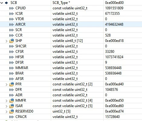

inside the hardfault_handler I read the SCB and get the following
0693W00000AOWdmQAH.jpgwhich gives a BFSR register error at address 0x20010000 which points to a reserved space
Any ideas what I'm doing wrong ? According to the example you don't need to do anything else after you have loaded new program to flash. Just set MSP and jump.

Is the code present? You should check the values are valid before jumping, and perhaps checksum or sign the image.
Have you tried stepping into the code?
The VTOR looks to be zero, check that the SystemInit() on the application side sets the address properly.
What's the address of the fault?
What happens if you don't set the MSP, but rather set the SP in the app's Reset_Handler ?

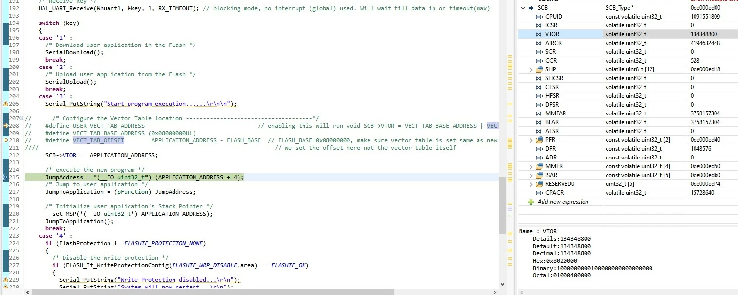

I assume that when the new blink code starts to run after the jump then the SystemInit() will run with the following
void SystemInit(void)
#if defined(USER_VECT_TAB_ADDRESS)
 /* Configure the Vector Table location -------------------------------------*/
 SCB->VTOR = VECT_TAB_BASE_ADDRESS | VECT_TAB_OFFSET;
#endif
But for SCB-> VTOR to get set I need to have defined the USER_VECT_TAB_ADDRESS
I tried this also below but still crashes
// /* Configure the Vector Table location -------------------------------------*/
	 #define USER_VECT_TAB_ADDRESS
	 #define VECT_TAB_BASE_ADDRESS (0x08000000UL)
	 #define VECT_TAB_OFFSET APPLICATION_ADDRESS - FLASH_BASE
 SCB->VTOR = APPLICATION_ADDRESS;
 /* execute the new program */
 JumpAddress = *(__IO uint32_t*) (APPLICATION_ADDRESS + 4);
 /* Jump to user application */
 JumpToApplication = (pFunction) JumpAddress;
 /* Initialize user application's Stack Pointer */
 __set_MSP(*(__IO uint32_t*) APPLICATION_ADDRESS);
 JumpToApplication();
If I set SCB->VTOR = APPLICATION_ADDRESS;
without the defines I get the VTOR set correctly before jumping but after debugger crashes

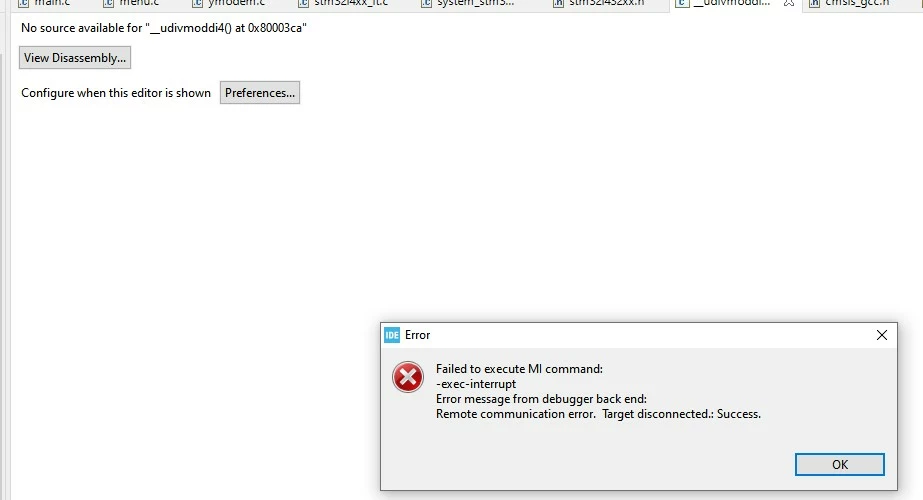

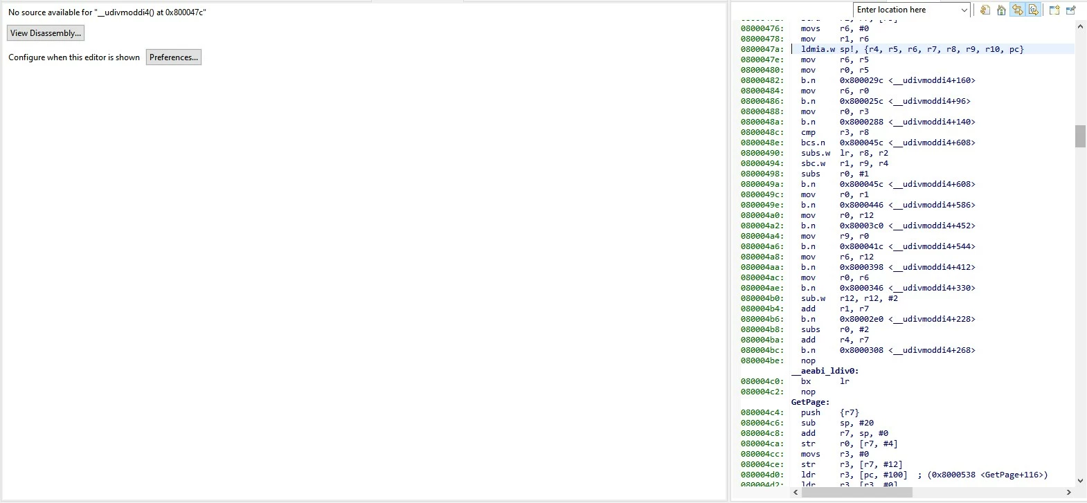

I added  __disable_irq(); before jump. Disassembly just before it crashes
0693W00000AOX6AQAX.jpg0693W00000AOX6UQAX.jpgAbout the link file. I don't see why I need to change it. I'm transferring a binary file.

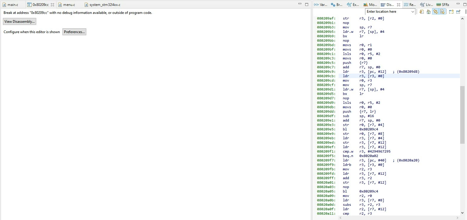

Fixed that too Thanks :) It still stops at some point later (0x8020a0a) but at least we made some progress.
Jimis
JimisAuthor
May 17, 2021
The fact that I get 0x8020a0a at the disassembly should be good which means that jump has succeeded but how can I debug further ?
I can't understand what the assembly is doing and can't see C code.
Is there a way to put a breakpoint at the beginning of my new loaded code?
