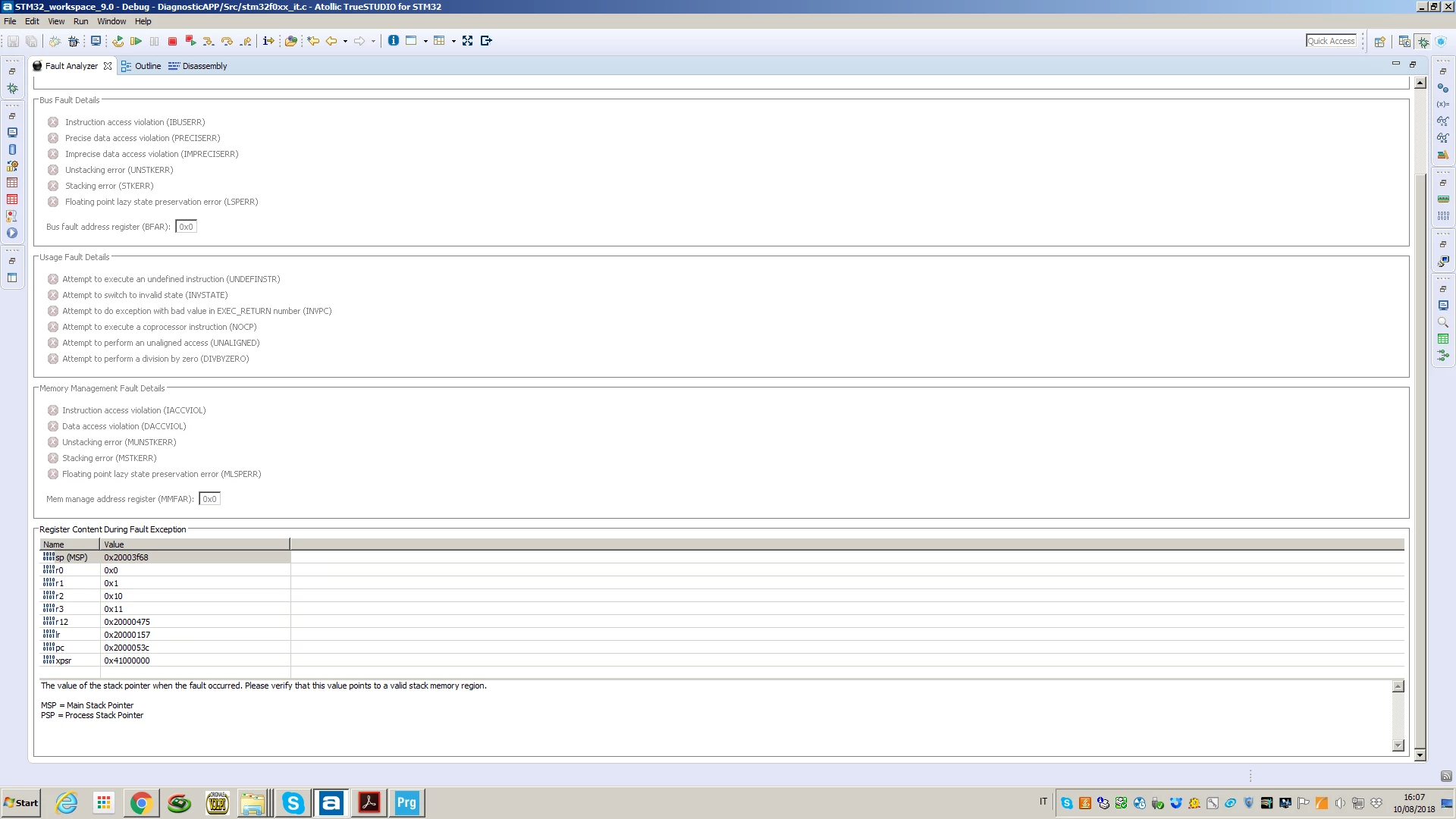

EDIT3
I've debugged application and I obtained the Fault Analizer image as follows
I notice that SP and PC are pointing to valid memory regions. I've not any information that can help me more....
