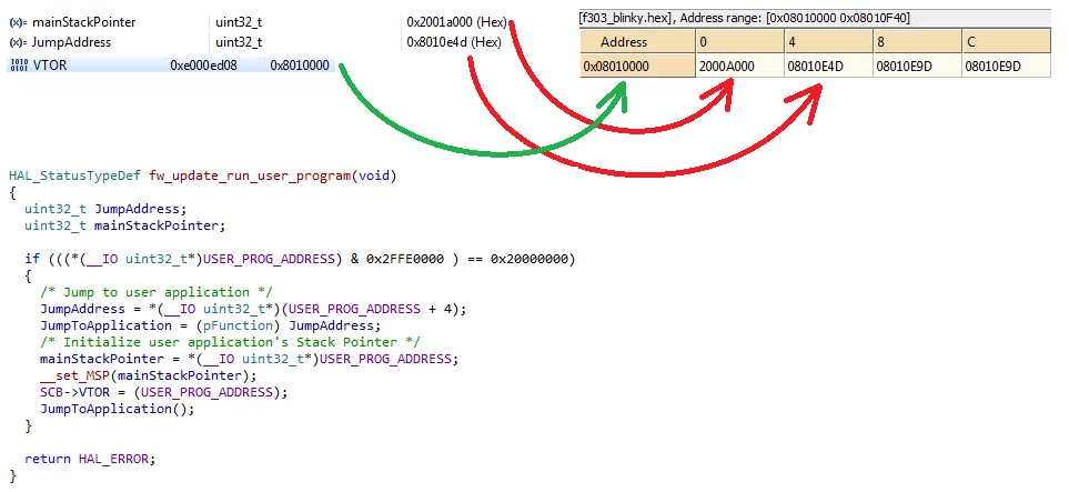

Michal Dubovsky
Aug 15, 2017 3:05 PM UTC
Posted on August 15, 2017 at 15:05
I have searched forum for ideas beforehand but none of them solved my issue.
I have modified the code slightly. This is what I got from the debugger.
Tesla DeLorean
Guru
Aug 15, 2017 4:36 PM UTC
Posted on August 15, 2017 at 16:36
That's not going to help if code in your app changes it. Step into the application code and follow it through to main()
Make sure you don't call from within interrupt context.
