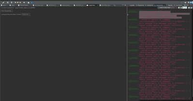

Hi, I have some problem about IAP.
It's not working application after jump from custom boot.
- MCU : Stm32F446RC
- Board : Custom board
- Boot address : 0x08000000 ~ 0x0801FFFF (128k)
- Application address : 0x08020000 (384k)
- Custom Boot Flash.ld
- Application Flash.ld
- Application system_stm32f4xx.c
- Jump to App code

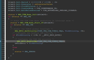

I got the problem here
- HAL_Init() -> HAL_InitTick(TICK_INT_PRIORITY) -> HAL_NVIC_EnableIRQ(TIM8_TRG_COM_TIM14_IRQn) in stm32f4xx_hal_timebase_tim.c
Anyone have some solution?
Please answer me.
Thanks.

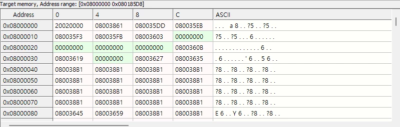

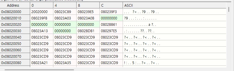

-it's custom bootloader address
-it's application address
i got the problem after Jump from boot to application.
bootloader firmware is working well

Use the Debugger, and step over the code.
Make sure that the vector table has viable content, and not filled with 0xFFFFFFFF
Failure suggests you're jumping anyway, or you reactivate an interrupt and it vectors there. Perhaps validate entire image say with signing or CRC.
Be a bit more circumspect before changing the SCB->VTOR and handing off control. Instrument your code so it's more apparent what's happening and why.
