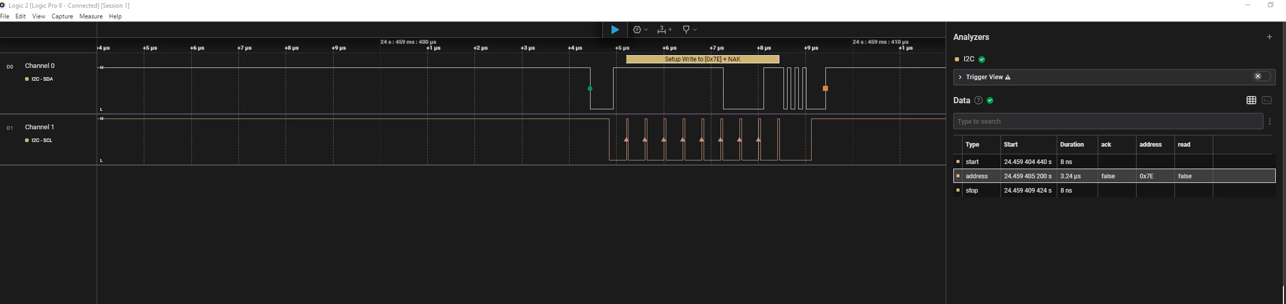

I'm using the I3C_Controller_ENTDAA_IT example to assign dynamic addresses to two BMA530 sensors, but I'm getting errors when running the code. Are there any modifications or additional steps I should consider to resolve this issue? I haven't made any modifications or additions yet.

Sorry, my mistake. I needed to load both the controller_entdaa_it and target_entdaa_it codes for the ENTDAA command to work. I had only loaded controller_entdaa_it. The problem is solved now.
