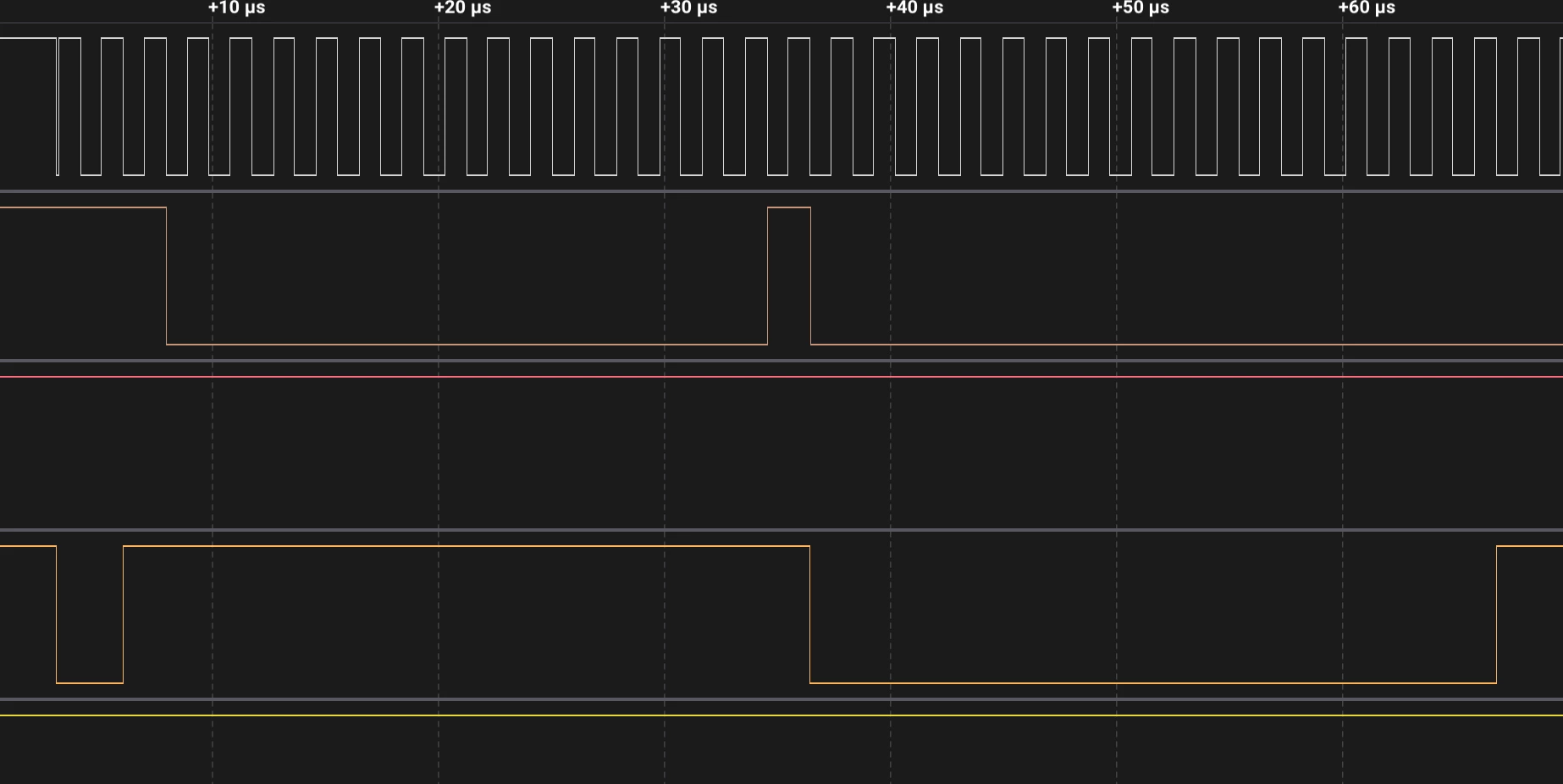

I'm getting a problem in my project, where I tried to create a loopback between I2S3 and I2S4 on STM32F411 Disco.
It seems that only the least significant bit of 16-bit packets is somehow shifted to the next packet. The rest of the transmission is intact.
For example - I send {0x0001 0x0000 0x0000 0x0000} and I get {0x0000 0x0000 0x0001 0x0000}, but if I send {0xFFFE 0x0000 0x0000 0x0000}, I will receive {0x0000 0x0000 0x0000 0xFFFE}.
Packets order reversal is expected, but during analysis pay attention what happens with the least significant bit. Another example: transmitting {0x8001 0x0000 0x0000 0x0000} will end up with receiving {0x0000 0x0000 0x0001 0x8000} (I'd expect {0x0000 0x0000 0x000 0x8001}).
What is also interesting, readouts from logic analyzer seem to be correct.

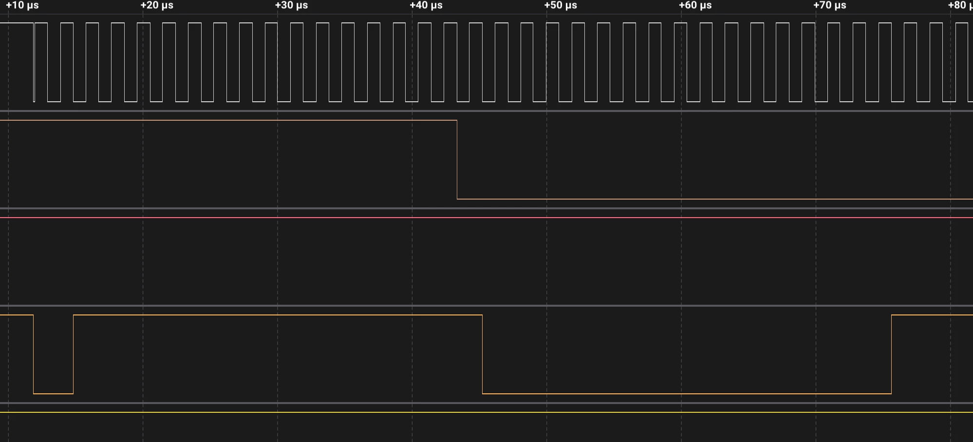

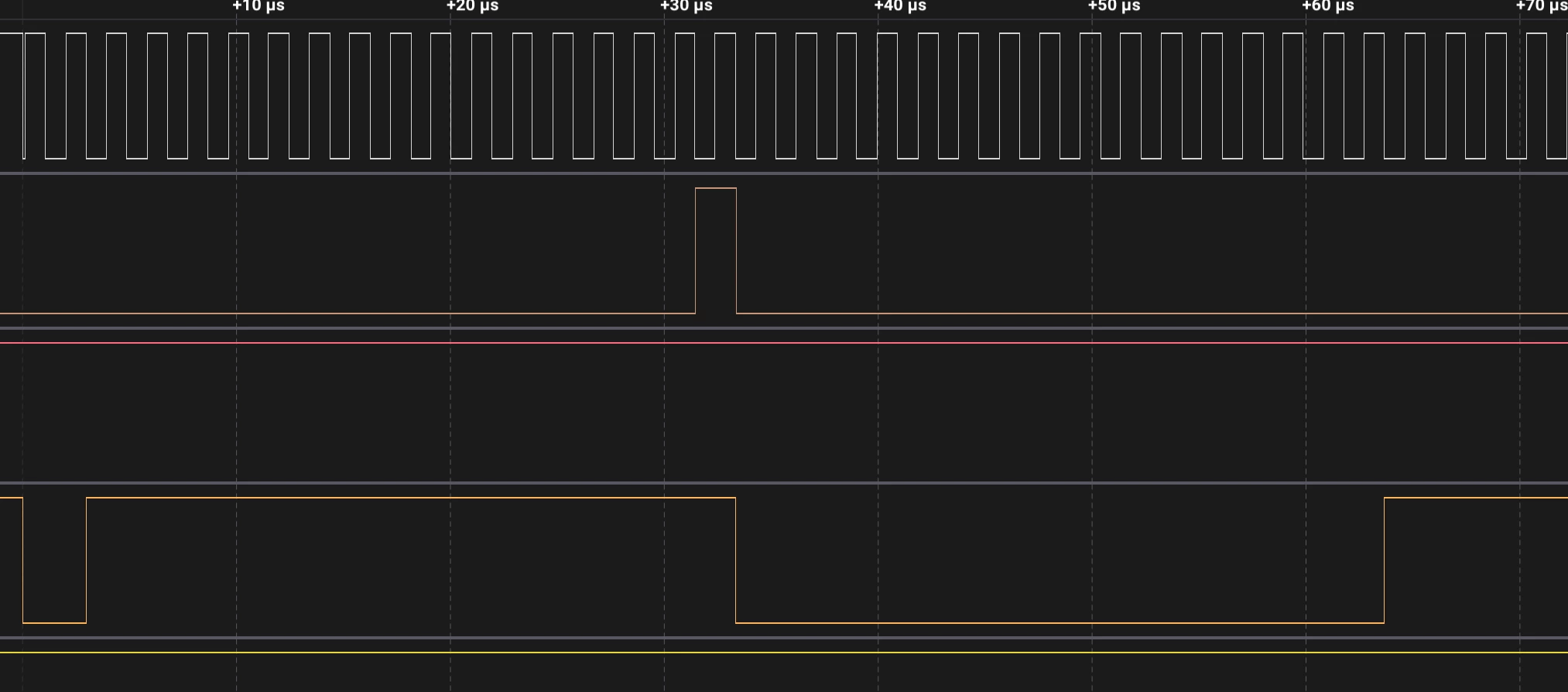

I already struggled with some edges during initialization - whole transmission was shifted by 3 bits. If I remember correctly I applied your suggestion about clock value from someone else's topic.
There are still indeed some extra edges in the beginning, but I suppose they are somehow discarded by STM - WS line does not go high during their period and after that, there are exactly 16 clock cycles during first '1'. I think that it would also cause shift of all of data - not only the least significant bits by a packet size.
Either way, I attached some LA captures below. To make it readable, I cropped two last packets - there were zeroes only, so nothing unexpected happened.
Data sent: 0x8001 0x0000 0x0000 0x000 0x8001 0x0000 0x0000 0x00000x8001 0x0000 0x0000 0x0000
Data sent: 0x0001 0x0000 0x0000 0x000 0x0001 0x0000 0x0000 0x00000x0001 0x0000 0x0000 0x0000
Data sent: 0xFFFE 0x0000 0x0000 0x000
0xFFFE 0x0000 0x0000 0x00000xFFFE 0x0000 0x0000 0x0000

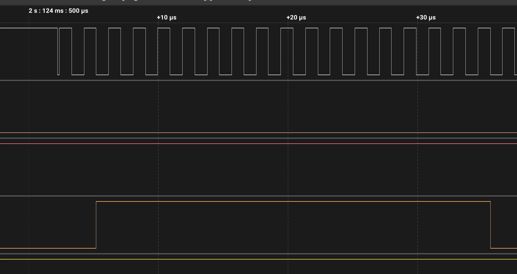

Btw, here is the start of transmission, where I made sure WS is pulled down low when I start both Tx and Rx.
Lead II
Jan 1, 2025 9:02 PM UTC
WS with pull-down does not fix, does not do anything (actively driven signals).
Your "problem" is: when all starts, the very first cycle is not correct (some BCK clocks but WS/LRCK changes - sure: now it goes to the 1st correct cycle).
This is due to the fact (for my understanding):
  • the output signals BCK and LRCK/WS are generated by the Master Receiver
  • so, you start Slave Transmitter first (which will wait for these signals, but never mind how long you wait: as long as the Master Receiver does not start - no signals)
  • afterwards you initialize and start Master Receiver (now starting to generate the signals)
  • and starting the Master Receiver starts with "strange" cycle, but Slave Transmitter is hot and sees this "strange" cycle
This creates a "kick-up" (incorrect first cycle). Your Slave Transmitter is confused and therefore the Master Receiver gets unpredictable Rx data.
What happens on the following cycles? Do not do all the time Start and Stop (let both run forever after enabled).
Have you tried to let both run forever and you pull-up or pull-down the DATA Rx input? What if you connect DATA Rx with LRCK/WS signal? (do you see 0xFFFF vs. 0x0000 in the two channels?)

Looking at your pin initialization code, you don't set OSPEEDR for the bit clock. Your problem thus may be the Corrupted last bit of data and/or CRC received in Master mode with delayed SCK feedback erratum. Try setting OSPEEDR to higher than the default lowest state.
baator025Author
Jan 2, 2025 9:35 PM UTC
Thanks, that did it! No more bit shift.
First I noticed that my implementation used APB1 for first I2S channel and APB2 for second one. There would be nothing wrong with that aside from that I set two different prescalers. After I fixed it, I noticed improvement, but some of the bits were still shifted.
After that I configured OSPEEDR and it seems that it fixed the problem.
Thanks again for the help. I'll remember to look for erratas, when I start working with a new MCU.
