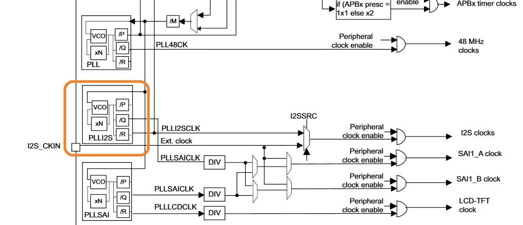

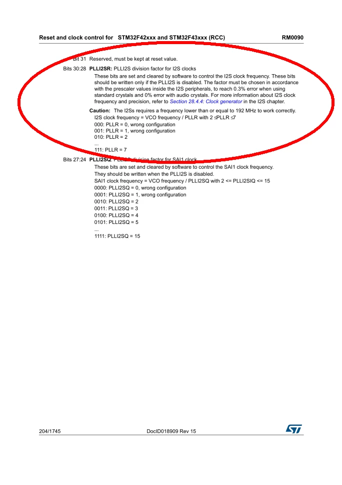

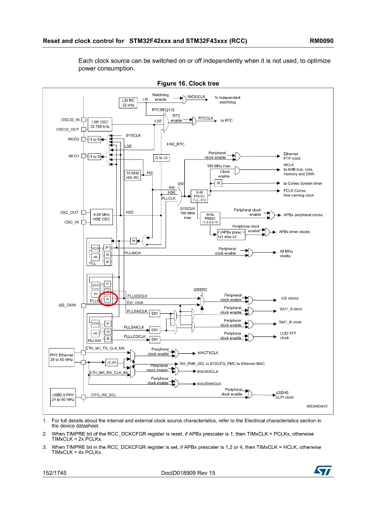

Hi - I'm trying to configure my STM32F429 Discovery board to send digital audio data to a
http://store.digilentinc.com/pmod-i2s-stereo-audio-output/
.  Section 28.4.4 (pg 911) of the
http://www.st.com/content/ccc/resource/technical/document/reference_manual/3d/6d/5a/66/b4/99/40/d4/DM00031020.pdf/files/DM00031020.pdf/jcr:content/translations/en.DM00031020.pdf
says:
To achieve high-quality audio performance, the I2SxCLK clock source can be either the PLLI2S output (through R division factor) or an external clock (mapped to I2S_CKIN pin).
I can't find any other mention (let alone an explanation) of what this 'R division factor' is.  Does anyone know what this means?

Each PLL has three divider taps for the VCO, P, Q and R. On the main one the P one goes to the processor, the Q to USB/SDIO.
Say you run the VCO at 360 MHz, a P setting of 2 gets you to 180 MHz.

Ah, got it, thanks! Makes perfect sense after showing it to me on the clock tree diagram.
