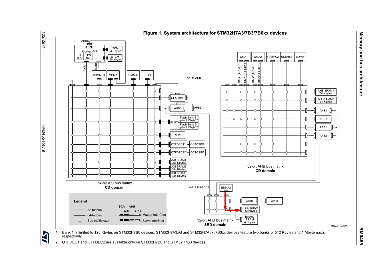

I2S on stm32h7b3i-dk not running :(
Hi guys,
I have a stm32h7b3i-dk board here and have been struggling with i2s for 5 days.
Can't get any further myself and have to ask for help.
I attached the project. Can someone please take a look?
The problem:
1.
HAL_I2S_TxCpltCallback is never called.
2.
Of course, I2S doesn't work.
I've tried everything possible, now create a new project.
It must have something to do with DMA... But I can't find the error.
Best regards and thank you in advance

OK so you've narrowed down the problem to being probably DMA-related.
One of the common reasons why DMA on 'H7 does not work is, that buffer is located in inappropriate type of SRAM, where the given DMA has no access. In your case, if you use BDMA2, only the "SRD" SRAM can be used, you have to locate your buffer there.
(btw. I don't understand why ST had the urge to rename the various clock/matrix domains in the 'H7B3 so that they don't match nomenclature of other 'H7, adding to confusion... but that's ST documentation crew for you.)
0693W00000QLMmwQAH.pngThere may be other reasons, too. Read https://community.st.com/s/article/FAQ-DMA-is-not-working-on-STM32H7-devices .

July 16, 2022
Thank you dude!!
