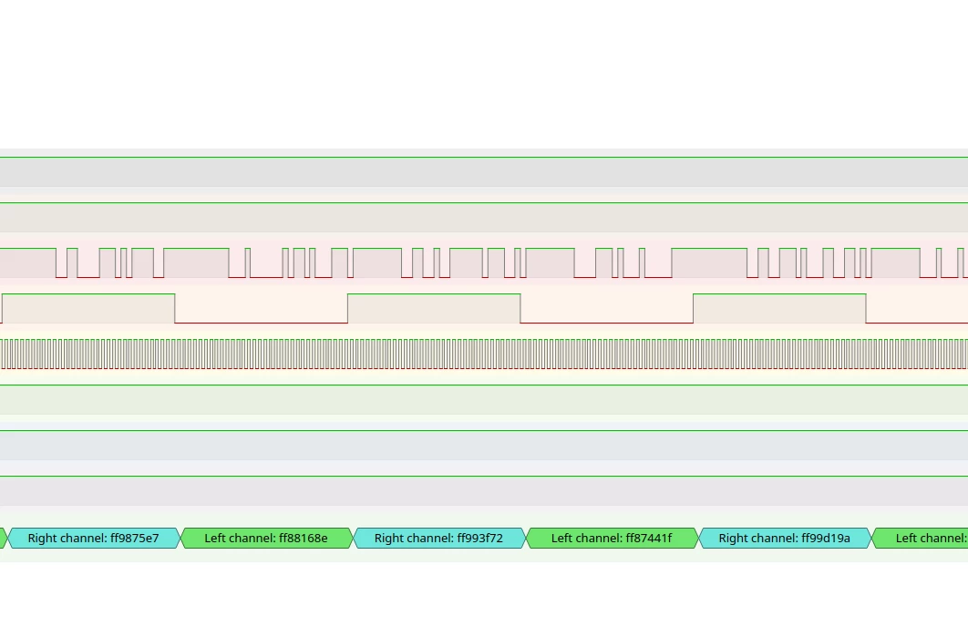

I am using a STM32F407 with the TLV320AIC3204 audio codec. I have verified that the I2S works with a logic analyzer:

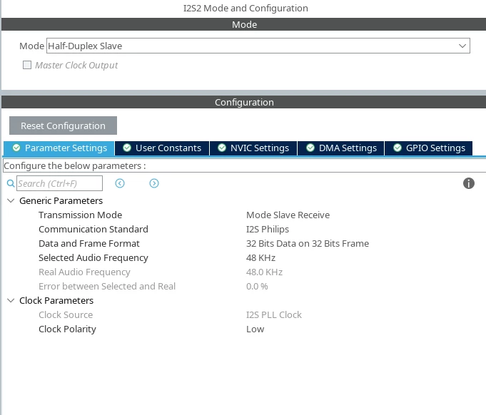

Here is my I2S configuration:

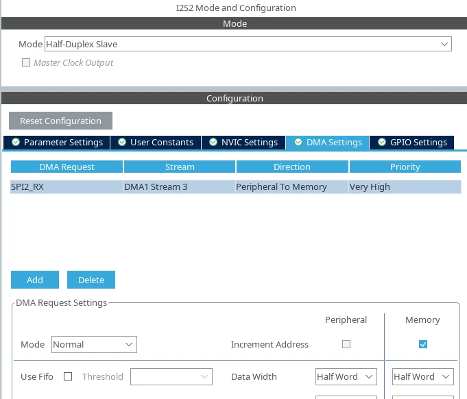

I made sure to add the following line to fix the DMA bug:
__HAL_RCC_DMA1_CLK_ENABLE();

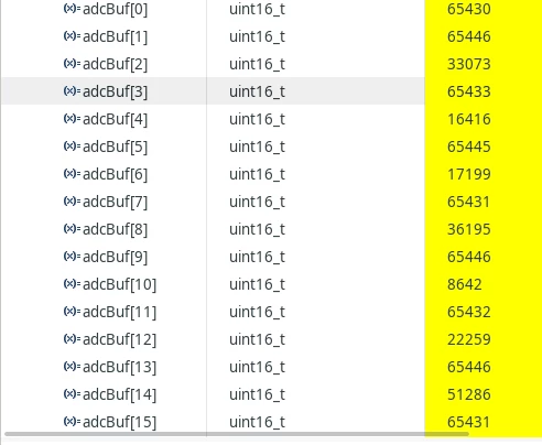

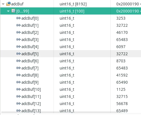

With lines 63 and 64 commented, I get random data sometimes (see picture below where I breakpointed on line 78, which is called after done = 1. You can see that the data is bit shifted by a random amount. There is nothing connected to the ADC, so the MSB should be close to 0xFFFF or 0x0000. However, these values are not.
I was able to fix the problem somewhat by uncommenting lines 63 and 64, which only allows the I2S to start when WS is low. (Trying it when WS=high gave me garbage every time). The issue now is that I am seeing the data offset by 16 bits sometimes.

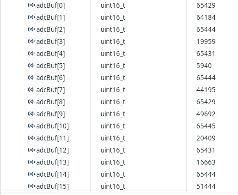

For example, here, the MSB are in the even positions (all of the numbers in the even positions don't change very much, and are close to 0xFFFF):
However, if I wait until the breakpoint is triggered again, I get
Now the MSB is in the odd positions. Any idea why this is happening? With lines 63 and 64 uncommented, on most runs the MSB is in the even positions the first time, and every time after that the MSB is in the odd positions.

Maybe I have overseen something in the posts above, but why do you use 32 bit I2S with half-word = 16 bit DMA?
If you're using only 16 bits ,maybe you can set the Codec to 16 bit, or maybe it's enough to just make the STM's I2S run with 16 bit?
enpassantAuthor
September 6, 2024
If we look at the HAL_I2S_Receive_DMA function, it only accepts 16 bit arrays for pData. So I am forced to use 16 bits for DMA too. I tried using "Word" instead of "Half-Word", but it just writes 16 bit values regardless.
You can also see that if it is 24 or 32 bits, the size of the array is multiplied by 2, since each sample takes up two 16 bit spaces.
Once I fix the issue I can rewrite the code to accept an array of 32 bits, which is cast into an array of 16 bits.
