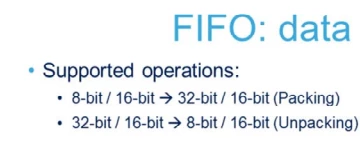

You dont want to try, what i recommended , so maybe good, you read about the DMA first :
https://www.st.com/resource/en/product_training/STM32F7_System_DMA.pdf
+ especially this:
And about audio processing:
https://www.eetimes.com/fundamentals-of-embedded-audio-part-3/

I've read through the DMA data sheet and I'm still not sure how to configure this properly. I can get the audio working but I'm just not sure its entirely configured right.
The DMA only works for "word" transfer so I'm trying to make sure I'm using the start function correctly and then I'm processing the incoming data correctly into a single value.
AScha.3
Jan 29, 2024 7:14 AM UTC
1. About the block size: I tried to show the "usual" way when using the circular dma, with some "useful" block size.
But if you intentionally want only one sample, to get lowest possible latency - ok, that is a reason for a single-sample "block". :)
Just it makes the dma almost useless , to transfer 1 sample and then let it generate the INT ; you could also just use the INT from the I2S and fetch the sample from the I2S receiver with the cpu and do the processing then - more simple and clear. ( The time needed to go to the INT is same, so at first no sense to use the DMA; but there could (!) be a gain of some cpu wait states, if cpu -> I2S data access needs more cpu wait states than RAM access, because the I2S is on AHB (120MHz) bus. But this is not so easy to test, so maybe ok to use the DMA - even only moving one sample. )
2. About the data size: You transfer 24b data -> 32b word is received/stored (because this is a 32 bit cpu, not a DSP with 24 bit data paths for audio ), so just handle and store it as 32b word, not divide in two 16b parts and put these together then again; also just to do it more simple ( and faster ! ). But maybe you have also some reason to intentionally use 16b parts, you just didnt tell me (same as the "why only one sample" thing) - is there a reason ?
