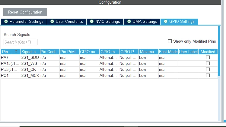

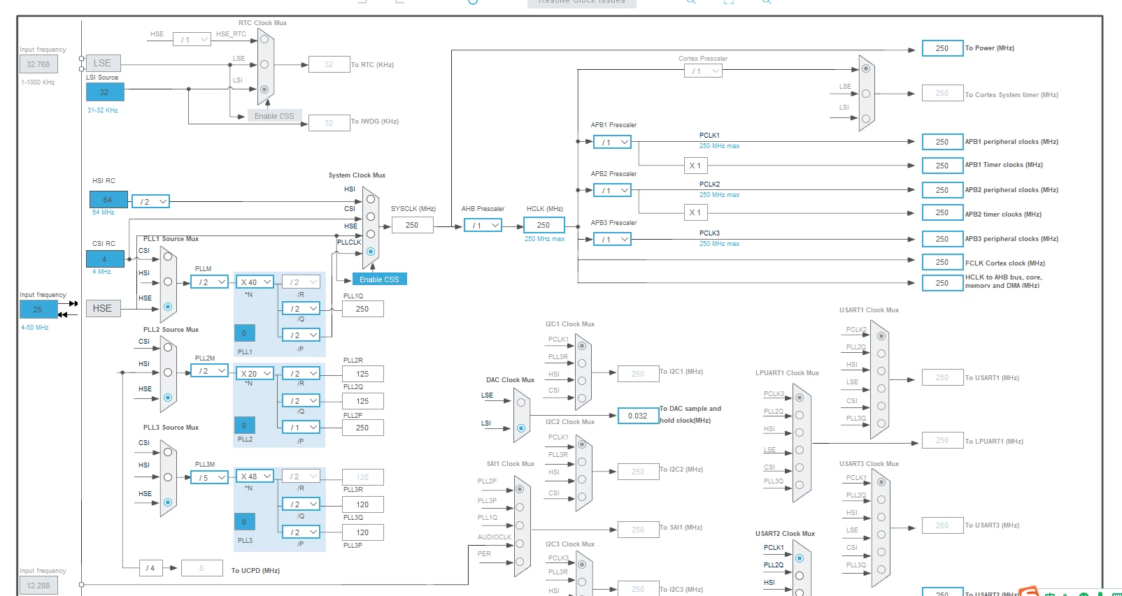

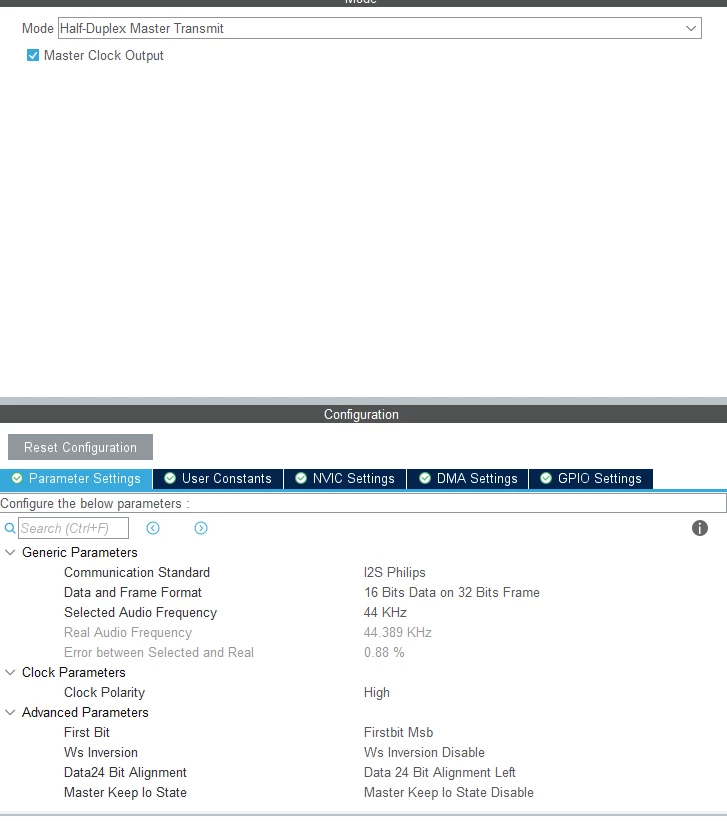

hello, i hope you are doing good. i am facing an issue in configuring i2s in dev board nucleo-h723z
issue i am facing is no clock at i2s2-sck pin.i tries all other i2s port also. i checked clock through logic analyzer .
here is my clock configuration:
i2s configuration:
pins:
i tried other i2s2_sck pins also
code :

I don't have a H7 or similiar MCU / board, to put this upfront.
Did you understand that I2C is open-drain, and you need pull-up resistors for the bus to work ?
They are essential in this case.
And you can't use the internal ones' (PUD configuration), they are too weak.
About 2k ...10k on each line is fine.
September 9, 2025
hello ozone thank you for the reply, but i am not using i2c. i am stuck at i2s configuration ,
Ozone
Principal
September 9, 2025
Ah, yes, you are right ...
Did you step into the code, and check the GPIO pins and I2S peripheral are set up correctly ?
