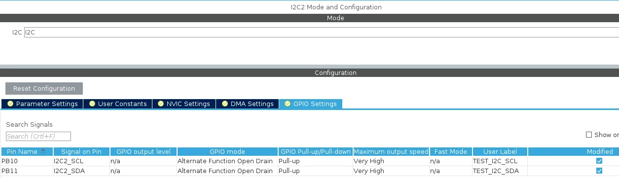

HW situation is:
I2C2_SCL on PB10 (pin L4)
I2C2_SDA on PB11 (pin M4)
Both have a pull-up resistor of 18K.
The sensor attached to these lines is removed, so nothing is connected.

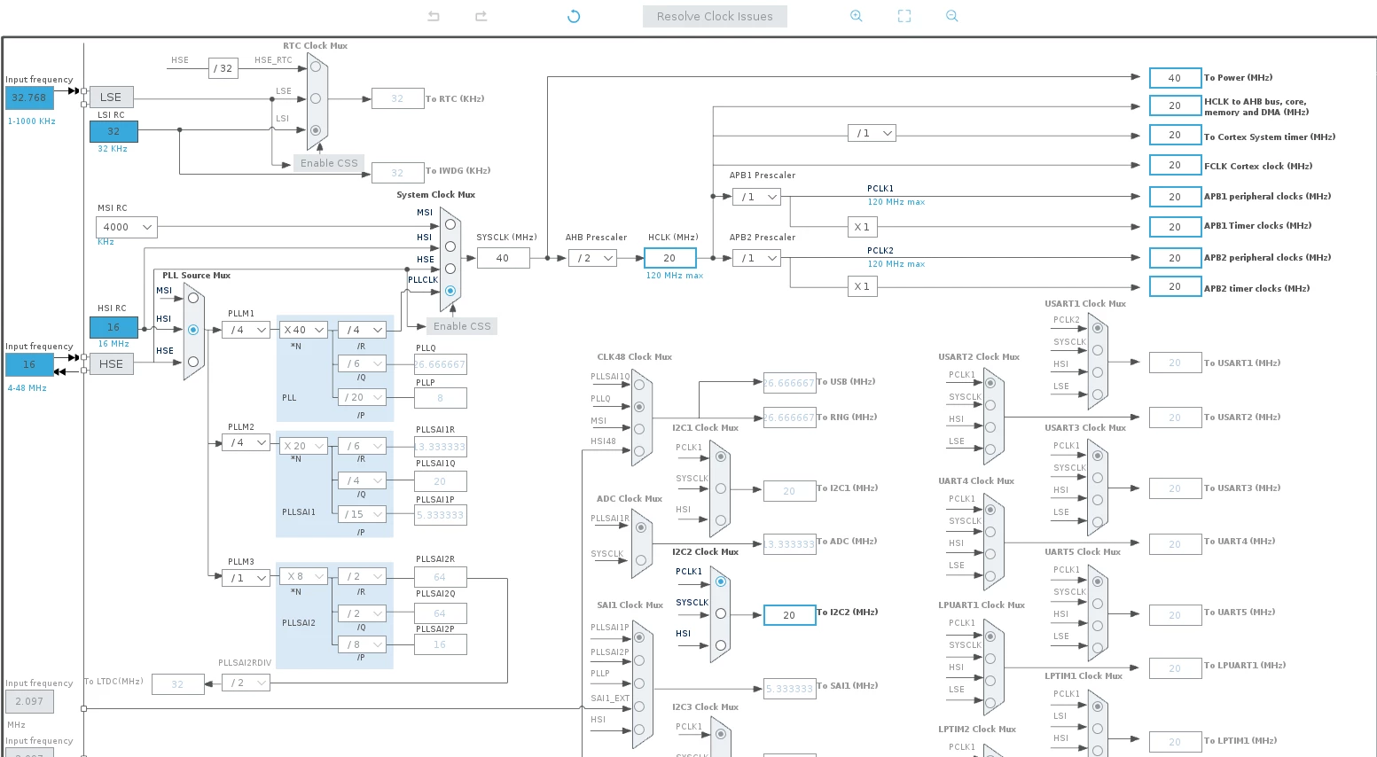

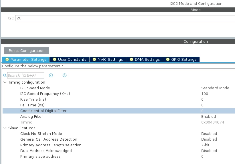

I have generated code through STMcubeMX (version 5.4.0).
Using the internal clock as a source:

status = HAL_I2C_Mem_Read(&hi2c2, 0xA0, 0x0F, I2C_MEMADD_SIZE_8BIT, &id, 2, 100);
The program gets stuck at:
static HAL_StatusTypeDef I2C_RequestMemoryRead(I2C_HandleTypeDef *hi2c, uint16_t DevAddress, uint16_t MemAddress, uint16_t MemAddSize, uint32_t Timeout, uint32_t Tickstart)
 I2C_TransferConfig(hi2c, DevAddress, (uint8_t)MemAddSize, I2C_SOFTEND_MODE, I2C_GENERATE_START_WRITE);
 /* Wait until TXIS flag is set */
 if (I2C_WaitOnTXISFlagUntilTimeout(hi2c, Timeout, Tickstart) != HAL_OK)
 return HAL_ERROR; //<=== we end-up here
And nothing happens on the SCL line, no clock signal. The SDA line is pulled down.

Yes, but it is a bit embarrassing to admit. The sensor device was removed but the address selection resistor not. And the address selection resistor was connected to the SDA line, pulling it down (address selection resistor had a lower value then the line pull-up resistors). Making the processor belief the line is not free, hence the time-out. So I decreased the line pull-up resistors and increased the address selection resistor. Hope this helps.
