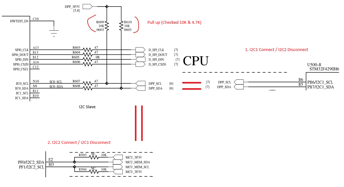

Andrew Neil
Jan 22, 2025 10:16 AM UTC
@Jdogk wrote:
The HW PCB completed, and the HW I2C pull up is the same.
Please show the PCB schematic.
Have you used an oscilloscope and/or logic analyser to see what's happening on the wires?

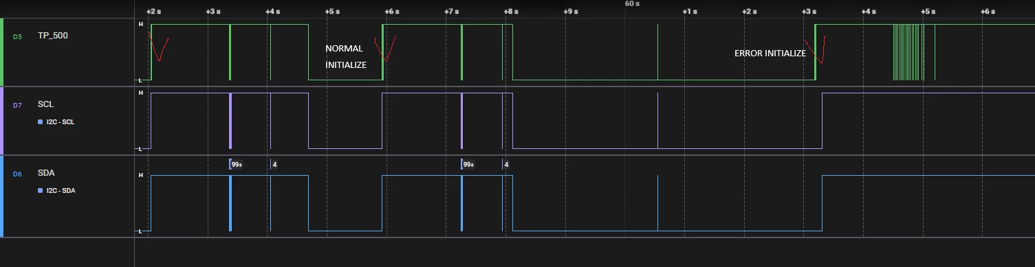

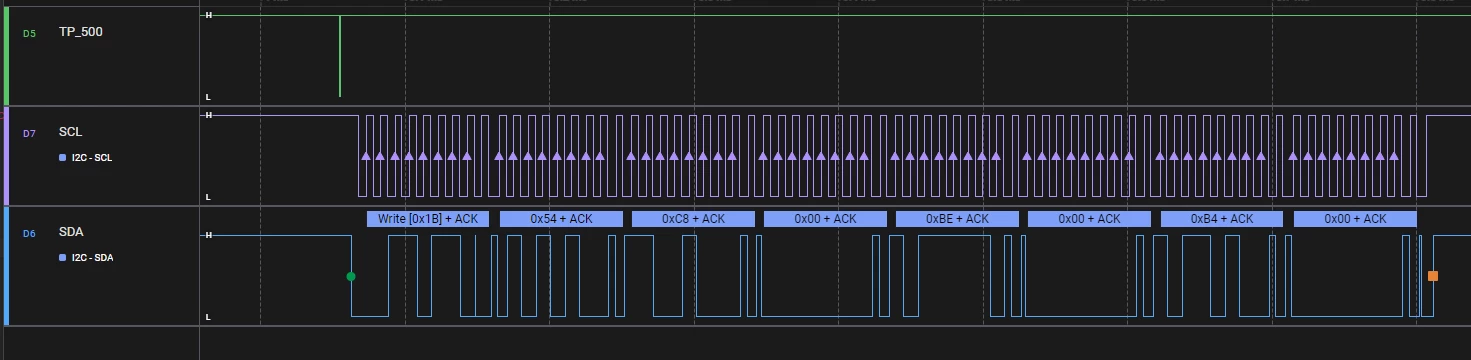

JdogkAuthor
Jan 23, 2025 4:20 AM UTC
Hi Amel,
My HW Setting is like this The first setting was I2C1 and the second setting was I2C2.
Created with Cubeide project,
#include i2c.h
MX_I2C2_Init();
MX_I2C3_Init();
in Main statement.
And I use TIM1(PWM), TIM2(Timer interrupt count), TIM4(PWM), TIM5(for us Delay Timer Count), TIM8(Input Capture mode)
in Debug mode I2C Master Transmit in to HAL BUSY Flag
Not initialize to HAL_I2C_STATE_READY
here is logic analyzer sequence
Above one is normal intialzie and normal I2C communication sequence
I Think I2C1 is not working in abnormal initialize

Main issue is I2C1 go to HAL BUSY Flag.. and system locked.
I think Not initialize to HAL_I2C_STATE_READY
This situation is often seen when you turn it on after first connecting the power, and it's working well afterwards.
