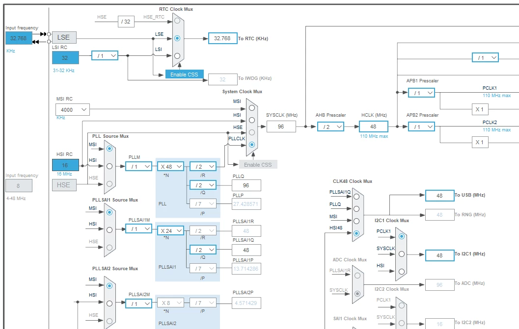

Please tell me about I2C timing configration.
I use Nucleo-L552ZE-Q.
I set up the I2C as shown in the picture following the reference manual(RM0438, Table 326).
The fi2cclk is 48MHz.
But SCL cycle is very slow.
How can I set the SCL cycle to 1000 kHz ?
Best regards.

Please review your clock configuration to ascertain that the peripheral clock is correct.  If the crystal is not oscillating, it may swich back to internal.

Thank you for your reply.
I checked my clock configration.
I don't use external clock.
Please let me know if there is something that needs to be changed.
