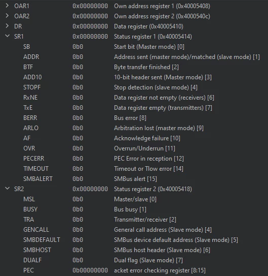

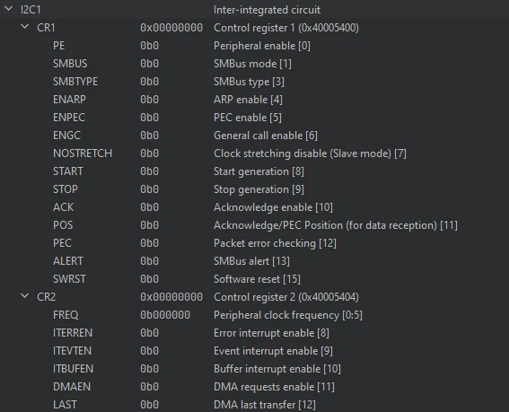

December 31, 2024
@TDK
Here is the debug information when error occurs (error being communication not starting)
Here is the TWI1 object I am using:
As we can see, the state switched to TWI_SENDING, which should mean start condition was sent but as we can see on the logic analizer, fifth start condition is never sent.
Here are the registers:
December 31, 2024
Your register output shows all 0s in the I2C1 registers. The peripheral is not even enabled, it's certainly not going to send a start condition.
I also do not see CR1_START high like you say it is in the first post.
Looks like you have a modified HAL-like structure. You should be initializing the peripheral in a manner similar to HAL_I2C_Init. The values in the software state handle are not what matters; ultimately the registers dictate how the peripheral behaves.
waclawek.jan
December 31, 2024
>  I didn't notice PE was 0, but I can ensure that I don't set it to 0 manually
You do that in resetTWI() --> LL_I2C_EnableReset(), indirectly, by setting SWRST.
After that, you would need to reinitialize the whole I2C machine.
However, the primary problem is that you call resetTWI() at all, so you should investigate there.
You may want to output some tracking/state information onto one of the pins (e.g. using UART at high baudrate) and observe that together with the I2C bus.
December 31, 2024
Thanks for the information, I thought SWRST didn't update the configuration registers.
Disabling the interface and reenableing it works fine.
