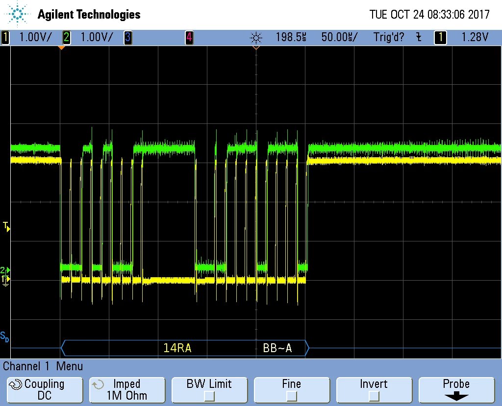

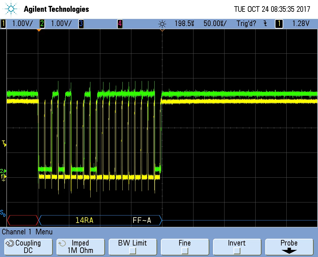

    With clock stretching:
    Without clock stretching:
    Could it be that the HAL_Library doesn't work without clock stretching in slave mode?

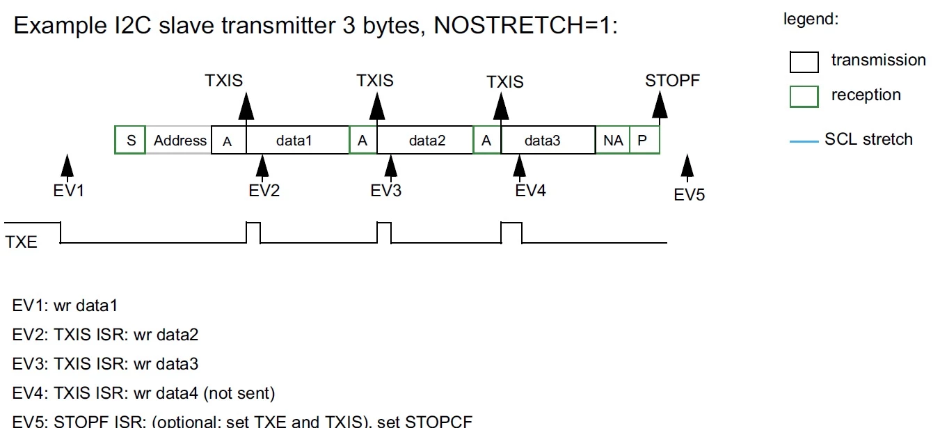

    I found the solution to my problem in the reference manual RM0360.

    Daniel Lengen
    May 16, 2018
    Posted on May 16, 2018 at 14:29
    Hello Pico
    I use the HAL library. Mainly the function  HAL_I2C_Slave_Sequential_Receive_IT() is used. So I receive sequence for sequence and I write manually in the register I2C1->TXDR the current transmitted value according the reference manual above.
    I set the transmitted value in the register after receiving the prior byte.
