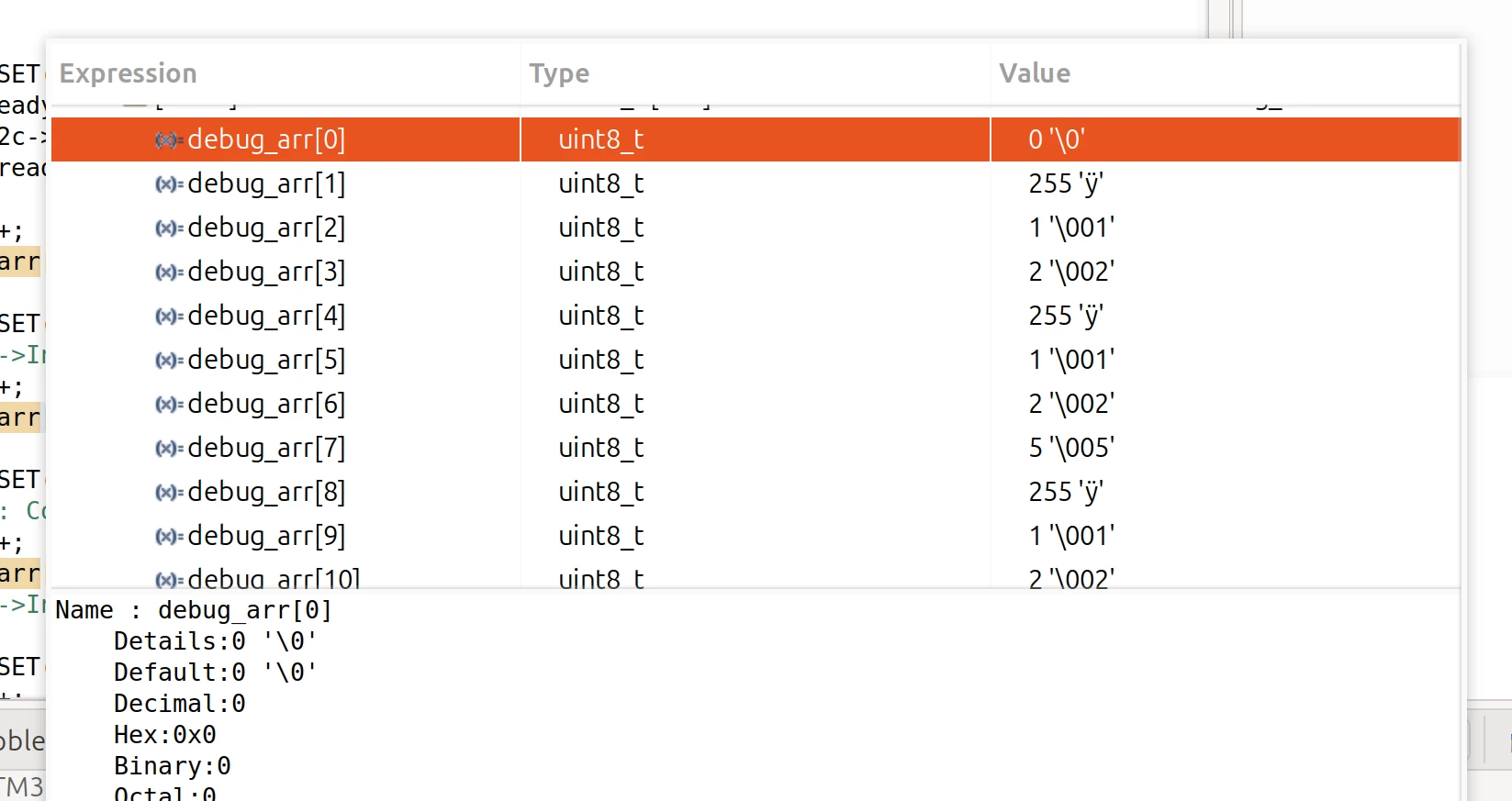

I shortened the EnableListen_IT function so it does no state-related stuff but only sets the PE-Bit, sets up the slave so it acks incoming messages, and enables the corresponding interrupts:
HAL_StatusTypeDef HAL_I2C_EnableListen_IT(I2C_HandleTypeDef *hi2c)
 /* Check if the I2C is already enabled */
 /* Enable I2C peripheral */
 __HAL_I2C_ENABLE(hi2c);
 /* Enable Address Acknowledge */
 SET_BIT(hi2c->Instance->CR1, I2C_CR1_ACK);
 /* Enable EVT and ERR interrupt */
 __HAL_I2C_ENABLE_IT(hi2c, I2C_IT_EVT | I2C_IT_ERR);
 return HAL_OK;
The two interrupts immediately jump to my own code:

My actual slave routine (which is called upon event-interrupts) checks if the last frame from the master was an addressing call, or just clocking out bits from the slave. I have some debugging variables in there (in order to create a history of interrupts and a "log" of what happened in the previous calls to the interrupt routine, so I could do some aftermath)
void JOJO_InterruptHandler(I2C_HandleTypeDef *hi2c)
 uint32_t sr1itflags;
 volatile uint32_t sr2itflags;
 sr1itflags = hi2c->Instance->SR1;
 sr2itflags = hi2c->Instance->SR2;
// if(sr1itflags = )
// sr1itflags = hi2c->Instance->SR1;
 call_count++;
 count++;
 debug_arr[count]=0xFF;
 uint8_t already_sent = 0;
 if(count > 22){
	 //sr1itflags = 5;
 if(IS_BIT_SET(sr1itflags,ADDR_FLAG)){
	 //Slave has just been addressed. Load Data to the DR reg.
	 //sr2itflags = hi2c->Instance->SR2; //read SR2 after new Data has been written to DR to clear ADDR-Flag
	 hi2c->Instance->DR = call_count;
	 already_sent = 1;
	 //sr1itflags = hi2c->Instance->SR1;
	 count++;
	 debug_arr[count] = 1;
	 //return;
 if(IS_BIT_SET(sr1itflags, TXE_FLAG)){
	 if(already_sent == 0){
		 hi2c->Instance->DR = call_count; //write data to DR reg as it has been loaded to shift reg
		 already_sent = 1;
	 count++;
	 debug_arr[count] = 2;
 if(IS_BIT_SET(sr1itflags, BTF_FLAG)){
	 //hi2c->Instance->DR = 0b11001100;
	 count++;
	 debug_arr[count] = 3;
 if(IS_BIT_SET(sr1itflags, AF_FLAG)){
	 //TODO: Communication done.
	 count++;
	 debug_arr[count] = 4;
	 hi2c->Instance->SR1 = 1 << AF_FLAG;
 if(IS_BIT_SET(sr1itflags, OVF_FLAG)){
	 count++;
	 debug_arr[count] = 5;
 if(count > 60){
	 count ++;
	 count --;
 return;
I first read SR1 and SR2 to reset the ADDR-Flag, then I look if an ADDR flag or a TxE Flag was set, so I load the DR-reg. (all the count++ and debug_arr stuff is for debugging).
When running the whole thing in debug-mode it seems to work as expected: First an interrupt with ADDR and TxE set occurs, after that only TxE and BTF are set at the following calls to the interrupt-routine. After the master has read all the bytes, it NACKs and I get an error, as I said I reset the AF-Flag and all seems to work as expected.

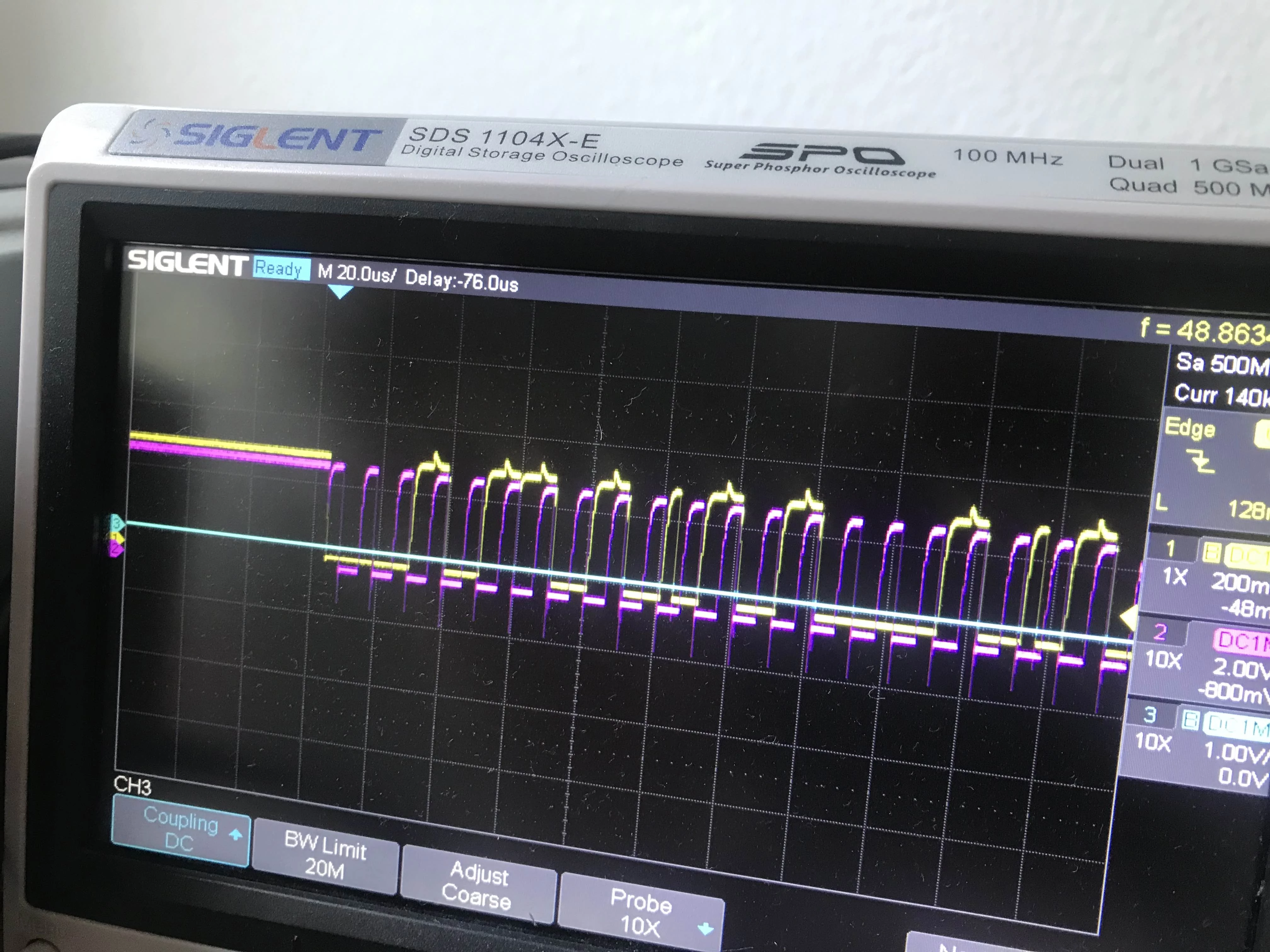

Yes I have a pin toggeling, which I can measure with my oszilloscope.
Edit: Ok, now, after having switched on a toggeling pin in my main loop, also the I2C seem to sometimes work. I have no clue how behaviour always seems to change. Sometimes it works, most times it does not. Oh boy. Even without the pin toggeling it works now a few programming cycles in a row.

Do you probe I2C bus with oscilloscope? Does it look reasonable?
If you do not get an ACK (instead a NACK) - do you see why on oscilloscope? (what the ACK signal looks like)
Do you have pull-ups (needed, I2C is Open Drain)?
The debugger should not have really an affect on I2C. Could you provide an oscilloscope capture for the failing I2C transaction? (I assume something wrong with pull-ups, signal strength, voltage levels)
It sound so me like: no pull-ups or too weak pull-ups.
July 19, 2024
I have 10k pull-ups.
Currently, everything is working. Here is a scope-shot of a successful transaction:
I really have no clue, why it did not work before. Before assume the 9th bit (ack) not being pulled down by my slave such that the address was not recognized and no further communication was being done. Still, the No-Stretch-Mode is not working.
You see, that when I switch off the clock-stretching, I go to my interrupt-routine and have my debug-array filled with these values, which means, that I keep getting over/underflow-errors, although I write my DR everytime the interrupt triggers. Why is that?
