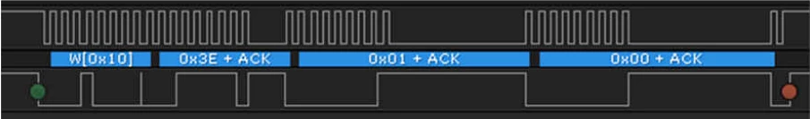

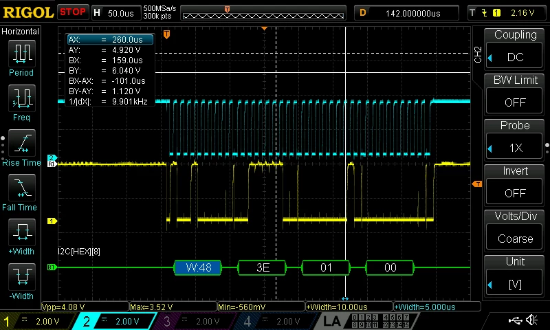

This is (with different address) what Master should create:
As you can see, here the example shows clock stretching - I have to work without this functionality.
The problem is, that my STM32 program is not working properly. The code for I2C slave device is provided below.
If HAL_Delay is called, the ACK is sent, but HAL_I2C_ListenCpltCallback is not called. If delay is not present the NACK is generated and Master can not proceed as desired.

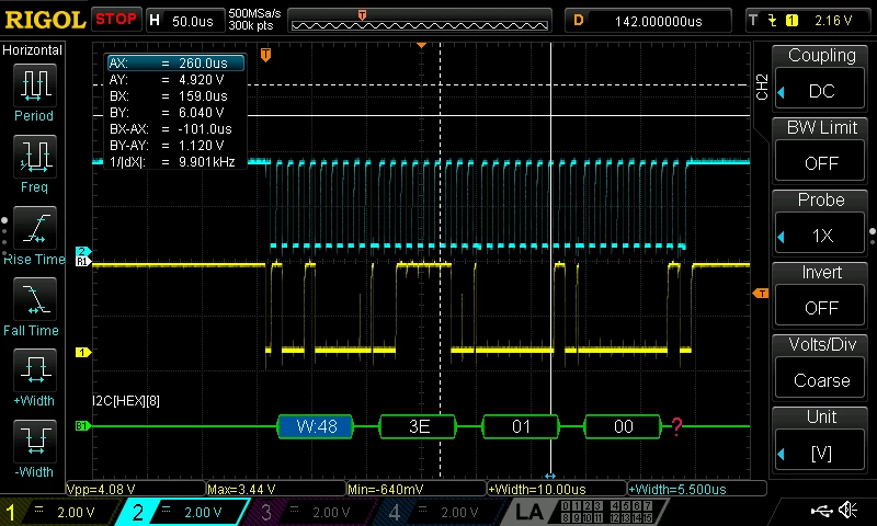

This is what I can see on my oscilloscope after probe procedure is called on the master in case of no delay in the STM32 code and bellow in case when delay is present in STM32 code.
But as said, if ACK is sent STM does not call HAL_I2C_ListenCpltCallback (as it should?) and in case of NACK master can't go on (in real life situation).

What I have notice I was doing wrong is calling HAL_I2C_EnableListen_IT in places I should not.
I have also make sure that the output speed for GPIO port is set to very fast and give it the priority of 0 (as in the linked example).
Now the the command from master can be received.
Next, when CLK stretching is disabled (on STM32 as slave9, I got OVR FLAG when calling seq_transive_it function and can not recover from it as flag can not be cleared. But this is somehow expected according to errata. Therefore I tried to enable the CLK stretching and after that the transfer seems to start but nothing is really happening (it stucks here). I believe that this is somehow HW/wiring error? Will have to check what is going on, but I'm without instruments at the moment.
In real life situation I will not have the availability to have CLK stretching enabled. What are my options then?

Answering to myself and potential readers again.
What have solved my transmitting from slave to master issue was the pull-up resistor (8kOhm).
Pull-up resistor can be further optimized based on real application I believe.
Nevertheless, now in test environment I can communicate in both directions with enabled or disabled clock stretching.
So to avoid problems (note to readers and myself):
  • call HAL_I2C_EnableListen_IT at start and after every HAL_I2C_ListenCpltCallback (or HAL_I2C_AbortCpltCallback).
  • make sure you have sufficient pull-up on both SDA and SCL lines (more details in manuals) to ensure stable communication.
  • handle state machine logic (if any) in main loop and exit from interrupt routine as soon as possible.
This topic can be closed now.
