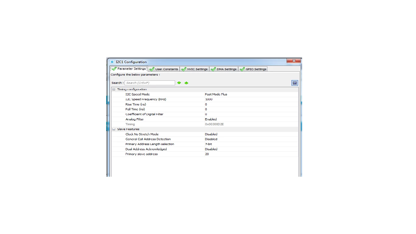

I2C Slave
when i configured my stm32 board as master then i transmit data but in slave mode it does not..i even tested the i2c example provided by Cube MX ,there also i can only transmit data in master mode,but not in slave mode...any idea please?0690X000006CA8uQAG.png

    On the I2C bus, ONLY the master can initiate a transmission.
    You need a master on the bus.
