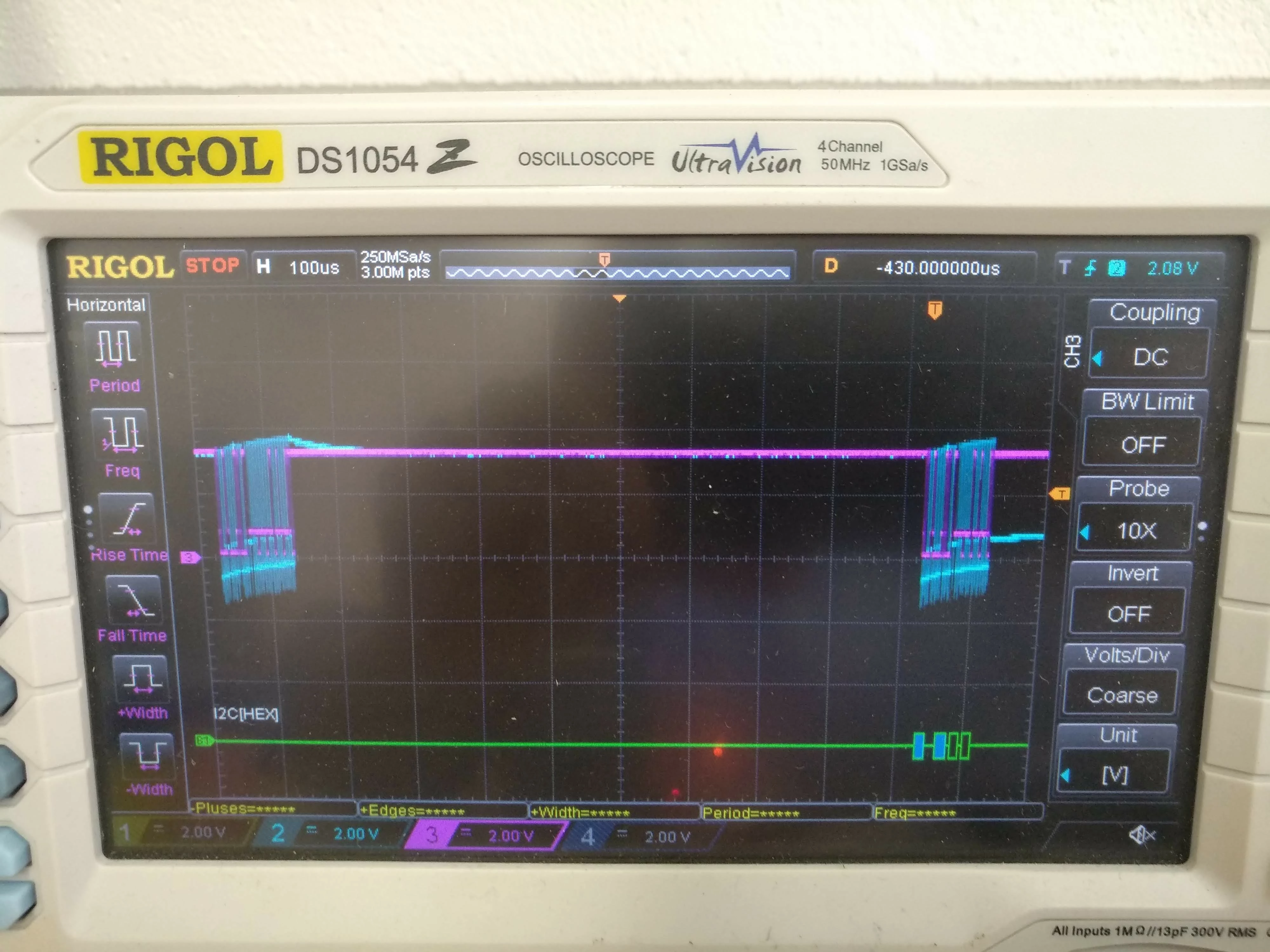

Here some captures from the oscilloscope:
Both rx/tx cycles. Clock line is kept low after 2nd tx because of the missing last byte I guess.

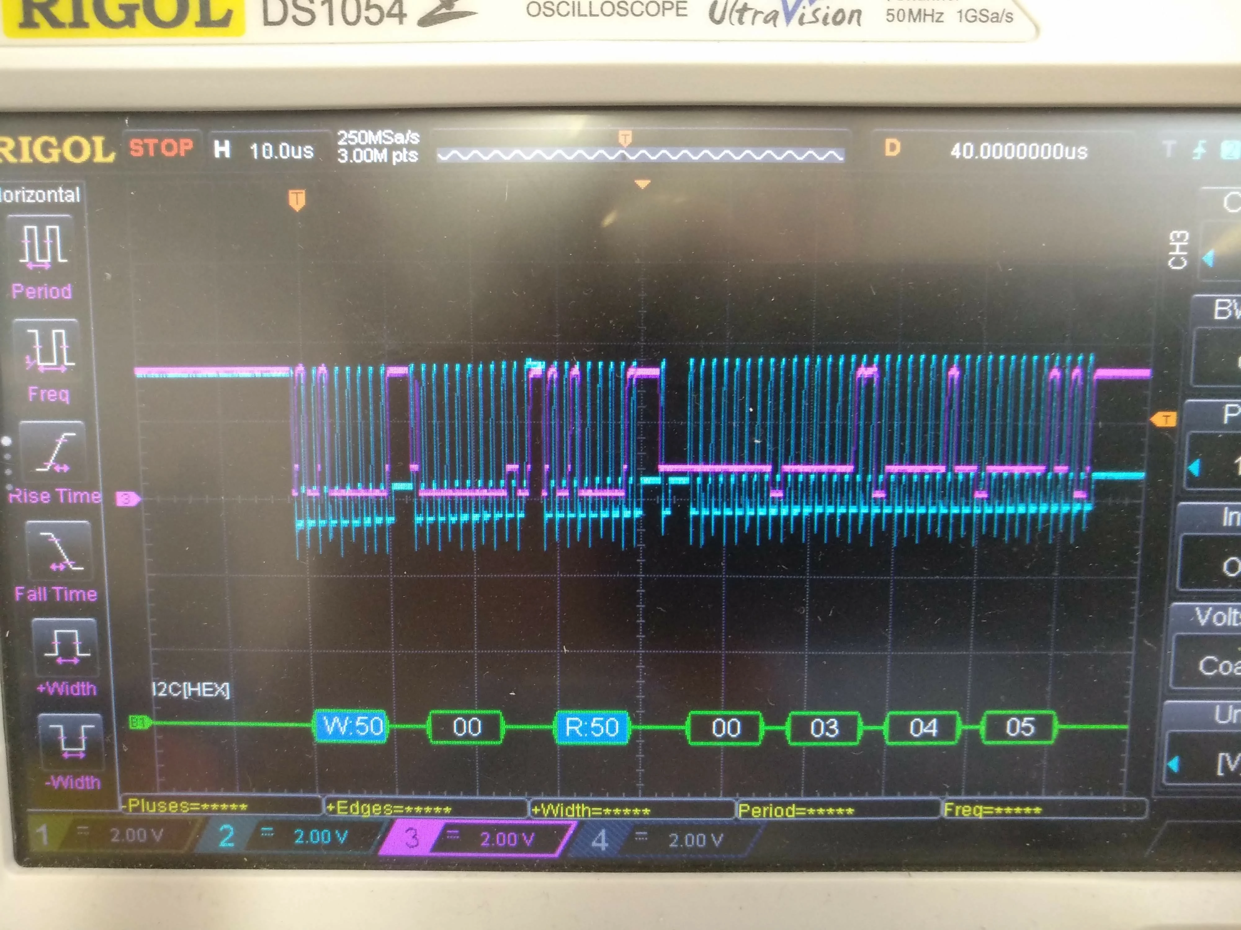

Data of first rx/tx. Notice the incorrect two bytes.

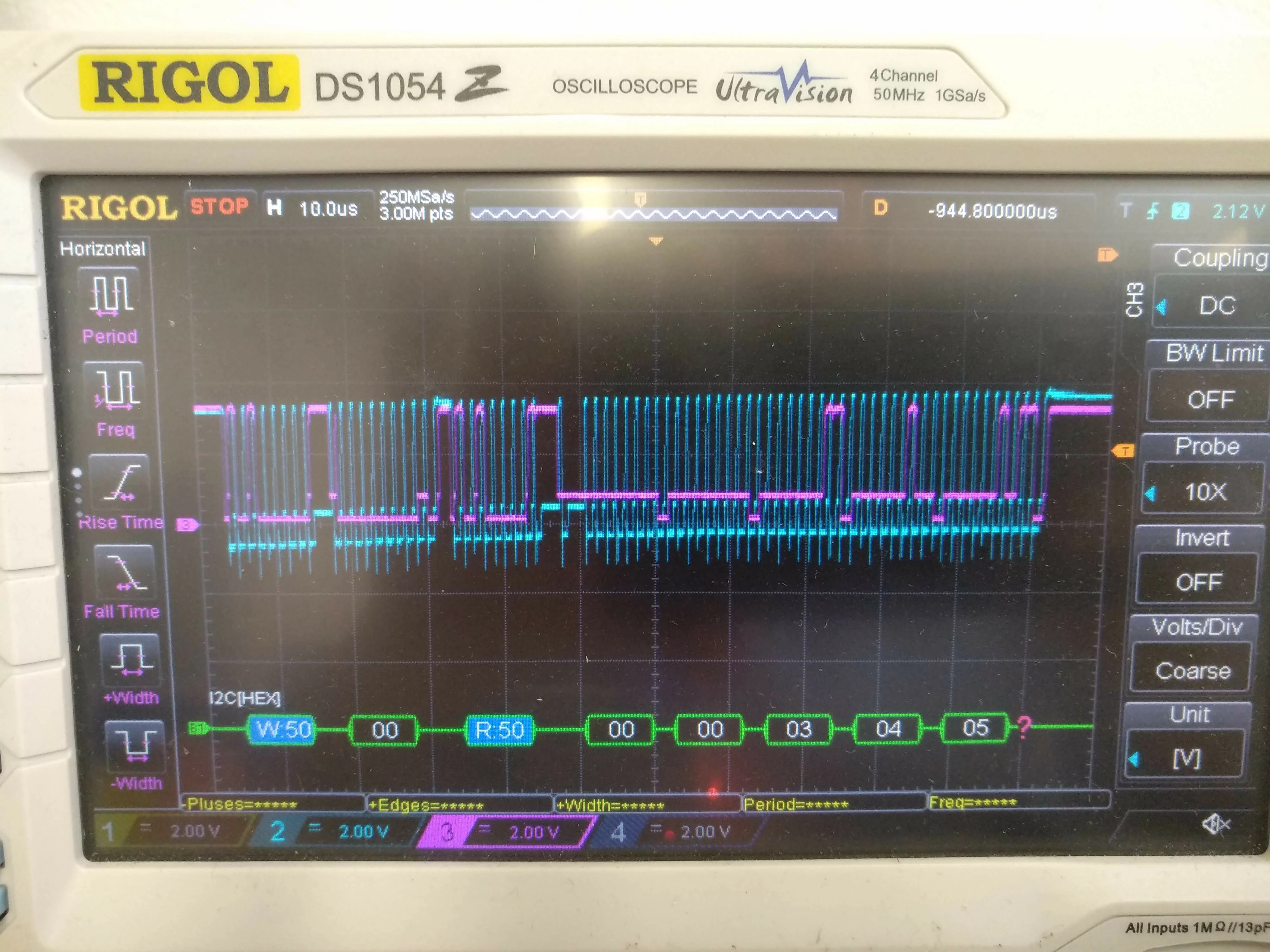

Data of second rx/tx.

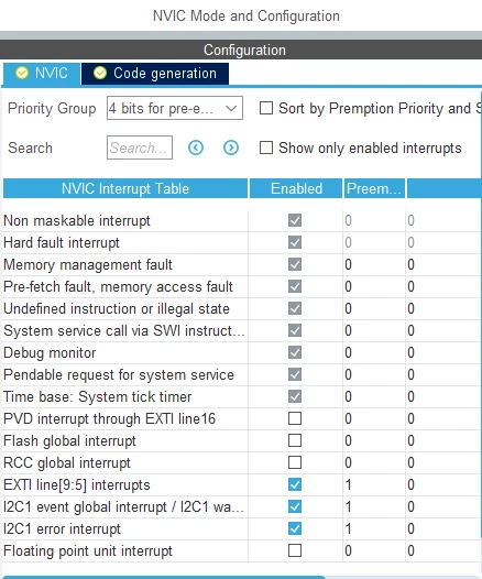

My Code is quite simple:
#define I2C_RX_SIZE 1
#define I2C_TX_SIZE 5
uint8_t i2c_rx_buf[I2C_RX_SIZE] = {0};
uint8_t i2c_tx_buf[I2C_TX_SIZE] = {1,2,3,4,5};
void main() {
while(1) {
HAL_I2C_Slave_Receive(&hi2c1, i2c_rx_buf, I2C_RX_SIZE, 200);
HAL_I2C_Slave_Transmit(&hi2c1, i2c_tx_buf, I2C_TX_SIZE, 200);

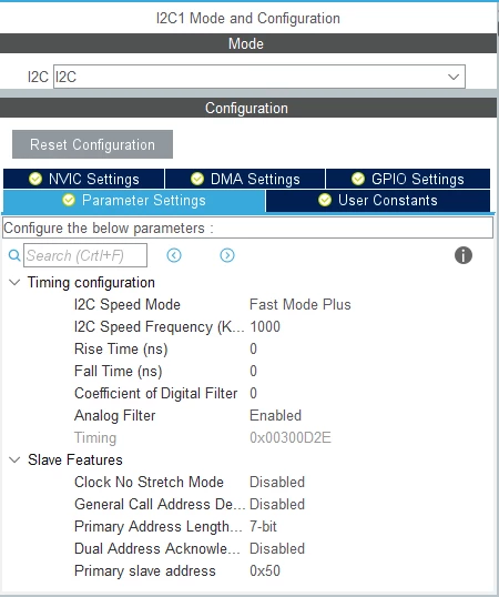

}Hardware configuration:
