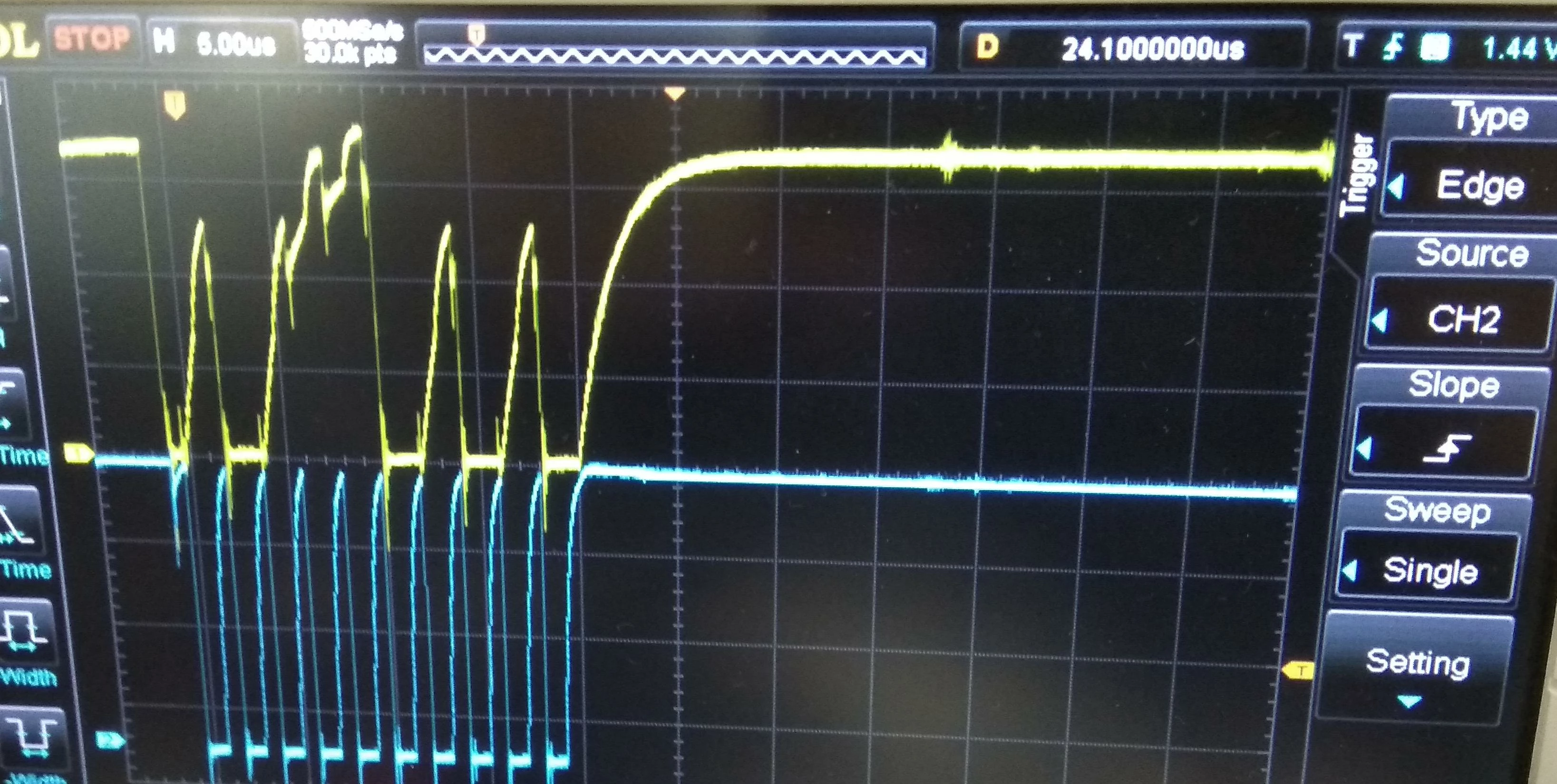

For few days I am trying to send some data over I2C2 interface. I am working with stm32f072-nucleo board.
Unfortunately something goes wrong because stm32 send only address with no data which should be transfered.
My configuration:

I am attaching oscillograms which shows that only address is being send.
Thanks in advanced for help!

Signal is very ugly, rising edges are too weak. Check pull-up resistors. it is likely that the slave devices does not answer at all because it is unable to recognize its address.
When this will be fixed, double check that the address send for the transfer is really 0xBB. This 0xbb looks like a seven bit address already shifted left by one bit, make sure that the transfer function does not shift once again.
Geoffrey Furman
January 2, 2018
Posted on January 02, 2018 at 14:41
