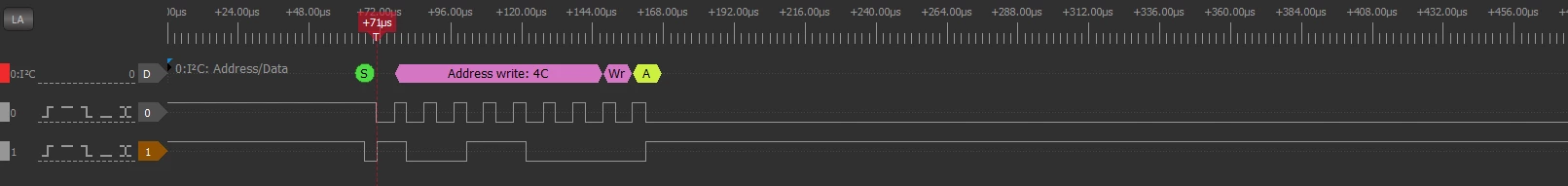

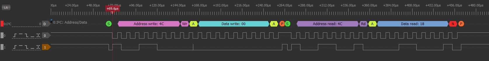

I'm looking for registers now. And I found, that I sent first good command to device, register ISR->STOPF is set to 0. After this sent  register ISR->STOPF is set to 1.
But after sent message I clear this register, but it is still in 1. And I don't know, why.
LL_I2C_ClearFlag_STOP(I2Cx);
How to clear ISR->STOPF bit register?
waclawek.jan
March 1, 2018
Posted on March 01, 2018 at 09:58
The device can't perform stop while SCK is held down (see your waveform for case 2).
As the status register is read during communication, store its changing value into an array, so that you have the whole history; then compare 'good' with 'bad'.
