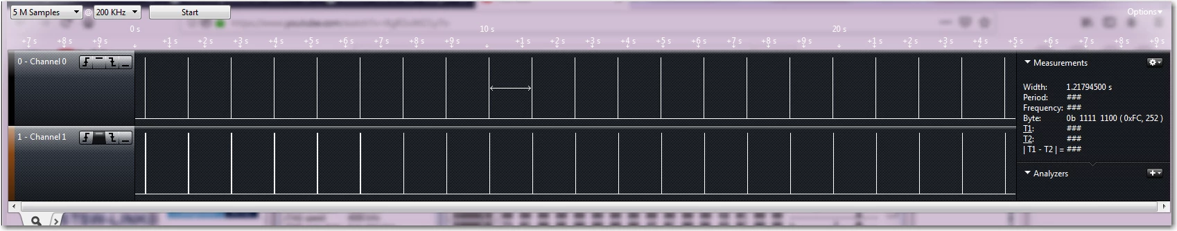

Dear Members,
I tried to initialize I2C in STM32F107
but got the straight line on Logic Analyzer,
I have no idea why ????
The code
void test()
	data_t[0] = 0x0C; //en=1, rs=0
	data_t[1] = 0x08; //en=0, rs=0
	data_t[2] = 0x0C; //en=1, rs=0
	data_t[3] = 0x08; //en=0, rs=0
	HAL_I2C_Master_Transmit(&hi2c1, 0x4E,(uint8_t *) data_t, 4, 100);

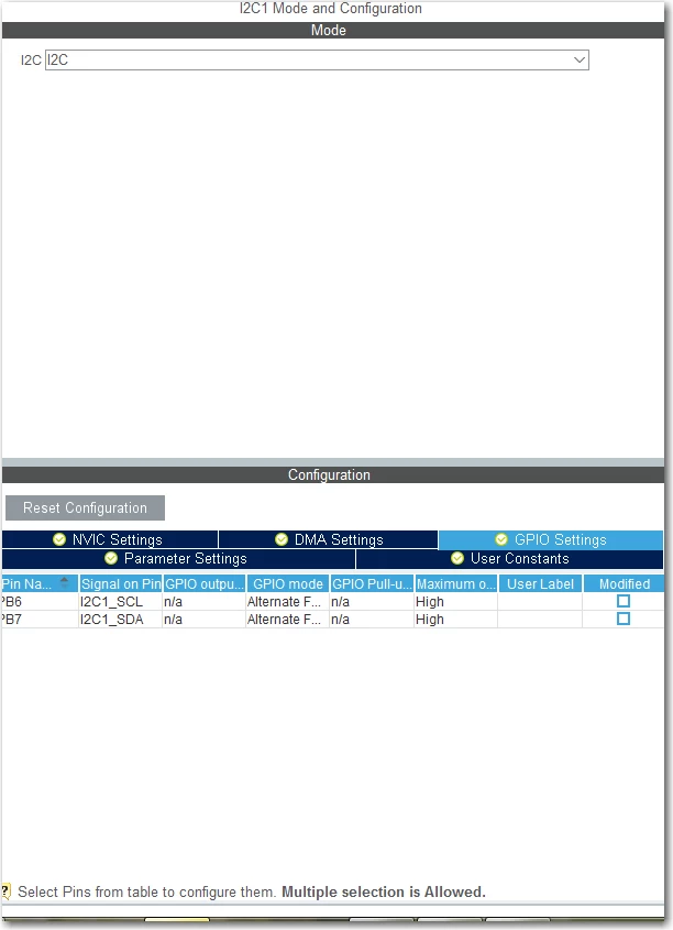

Is it by default in STM32CubeMX, the cpu acts as master ??
I tested PB7 and PB6, they are connected properly into my header pins...
I have no clue why...??

I2C_HandleTypeDef hi2c1;
/* I2C1 init function */
void MX_I2C1_Init(void)
 hi2c1.Instance = I2C1;
 hi2c1.Init.ClockSpeed = 100000;
 hi2c1.Init.DutyCycle = I2C_DUTYCYCLE_2;
 hi2c1.Init.OwnAddress1 = 0;
 hi2c1.Init.AddressingMode = I2C_ADDRESSINGMODE_7BIT;
 hi2c1.Init.DualAddressMode = I2C_DUALADDRESS_DISABLE;
 hi2c1.Init.OwnAddress2 = 0;
 hi2c1.Init.GeneralCallMode = I2C_GENERALCALL_DISABLE;
 hi2c1.Init.NoStretchMode = I2C_NOSTRETCH_DISABLE;
 if (HAL_I2C_Init(&hi2c1) != HAL_OK)
 Error_Handler();
void HAL_I2C_MspInit(I2C_HandleTypeDef* i2cHandle)
 if(i2cHandle->Instance==I2C1)
 /* USER CODE BEGIN I2C1_MspInit 0 */
 /* USER CODE END I2C1_MspInit 0 */
 __HAL_RCC_GPIOB_CLK_ENABLE();
 /**I2C1 GPIO Configuration
 PB6 ------> I2C1_SCL
 PB7 ------> I2C1_SDA
 GPIO_InitStruct.Pin = GPIO_PIN_6|GPIO_PIN_7;
 GPIO_InitStruct.Mode = GPIO_MODE_AF_OD;
 GPIO_InitStruct.Speed = GPIO_SPEED_FREQ_HIGH;
 HAL_GPIO_Init(GPIOB, &GPIO_InitStruct);
 /* I2C1 clock enable */
 __HAL_RCC_I2C1_CLK_ENABLE();
 /* USER CODE BEGIN I2C1_MspInit 1 */
 /* USER CODE END I2C1_MspInit 1 */

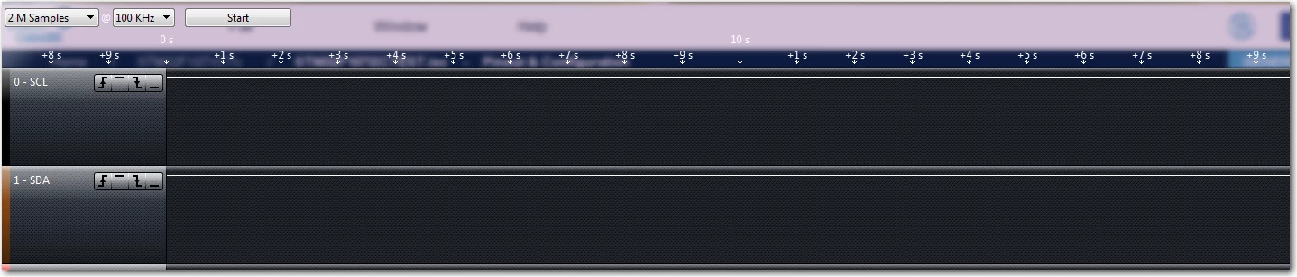

another question, do I need a pull up resistor for logic analyzer only ?
because it's open drain....
Tesla DeLorean
Guru
July 14, 2019
The pins look to be high. but yes I'd really think you'd either need internal or external pull-ups for correct operation.
Code doesn't look unreasonable, but not using F1+HAL here.
Going to have to walk hw registers, and external circuit, and check for error/status thrown via functions.

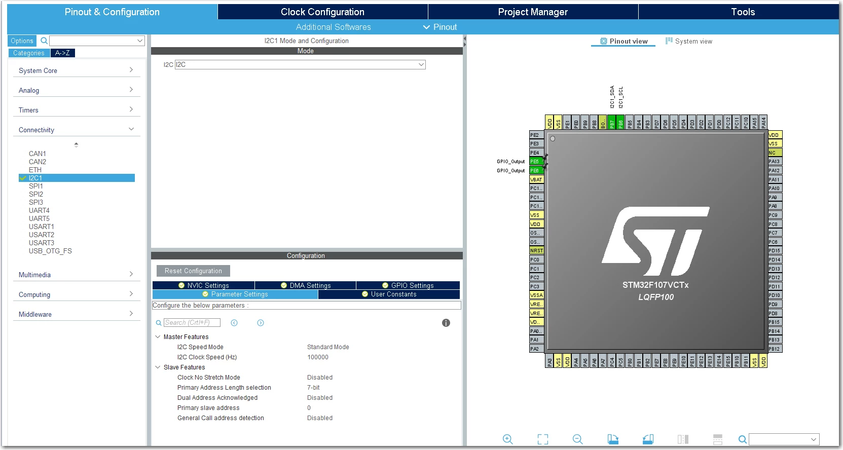

When I test the port as GPIO PB7 and PB6 are ok :
	HAL_GPIO_WritePin(GPIOB,GPIO_PIN_6,GPIO_PIN_SET);
		HAL_Delay(1);
		HAL_GPIO_WritePin(GPIOB,GPIO_PIN_6,GPIO_PIN_RESET);
		HAL_Delay(10);
		HAL_GPIO_WritePin(GPIOB,GPIO_PIN_7,GPIO_PIN_SET);
		HAL_Delay(1);
		HAL_GPIO_WritePin(GPIOB,GPIO_PIN_7,GPIO_PIN_RESET);
but as I2C, no luck yet ??

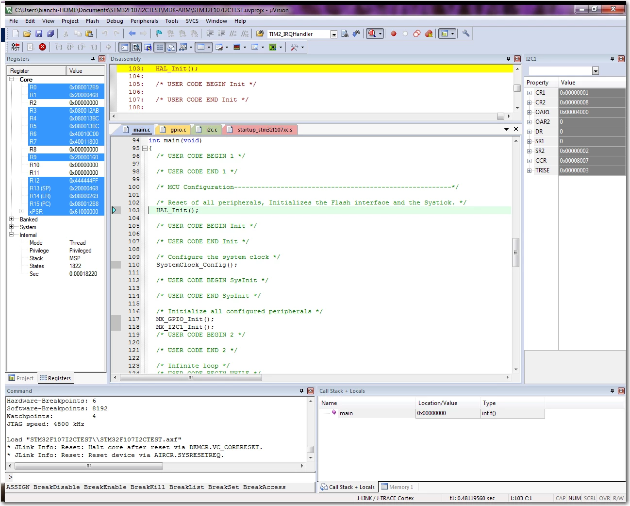

Is my APB1 Clock not working ?
antonius
antoniusAuthor
July 15, 2019
the I2C register
antonius
antoniusAuthor
July 15, 2019
from register, it looks like it's going to SMBUS mode, I didn't change that ??
