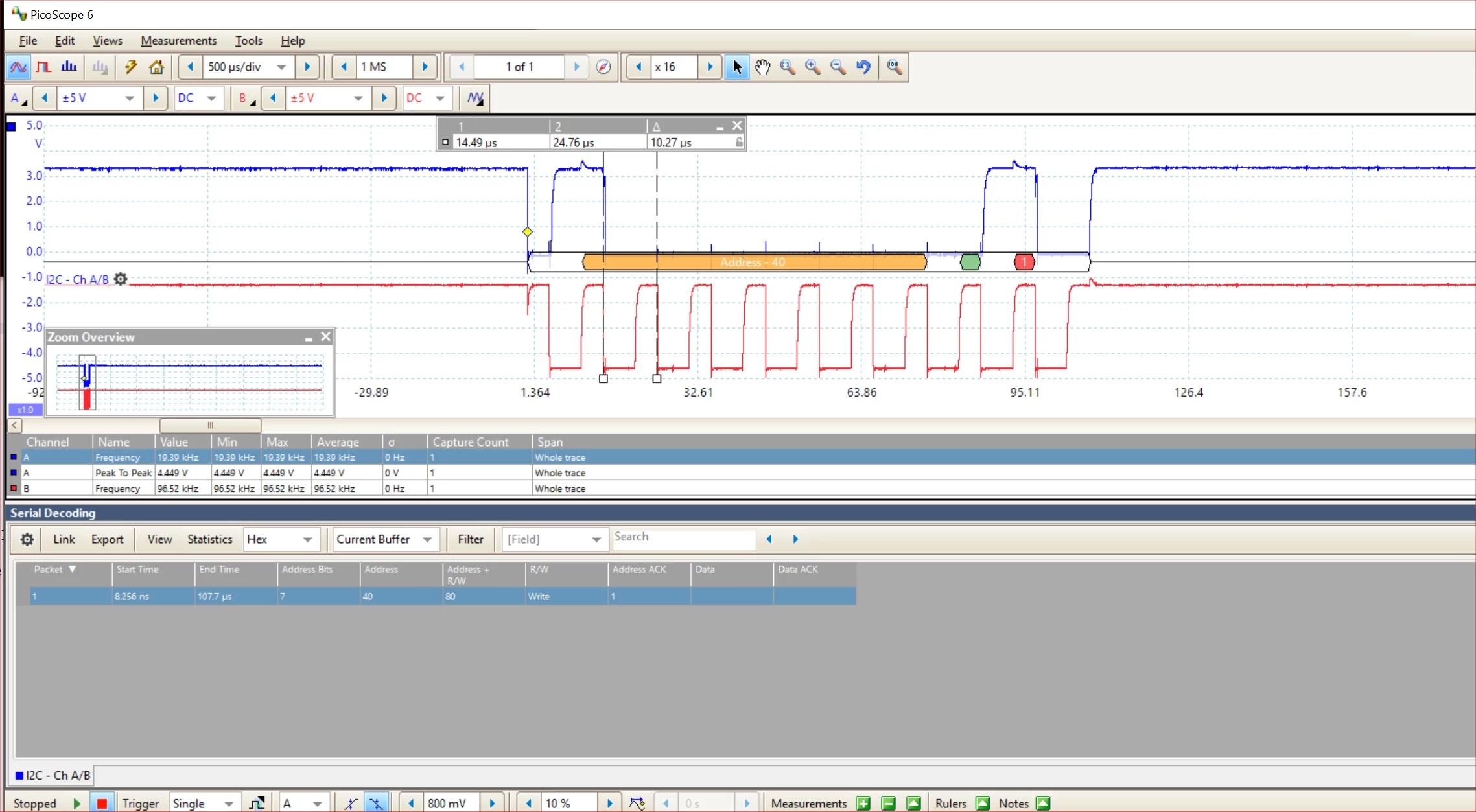

I2C problem on some devices on STM32L432 but not STM32L433
I've got an issue that the STM32L432 on the Nucleo running a simple I2C I/F isn't working with a DHUT21 when exactly the same code on the 433 is fine. The same I2C code on both chips works fine with a BMP180 and many other devices. This is reproducible across some but not all Nucleo-L432 boards - some work OK with the DHUT21. The signals look fine except that the sensor is NAKing the address on the 432. Any ideas appreciated.

waclawek.jan
Jan 10, 2019 1:33 PM UTC
The 'L432 and 'L433 I2C should be identical, so the difference lies in the external circuitry.
From the waveforms you've posted, SDA changes a tad bit too soon after SCL falling edge to my liking. Try to increase I2C_TIMINGR.SDADEL .
PS. Isn't it DHT21 rather than DHUT21?

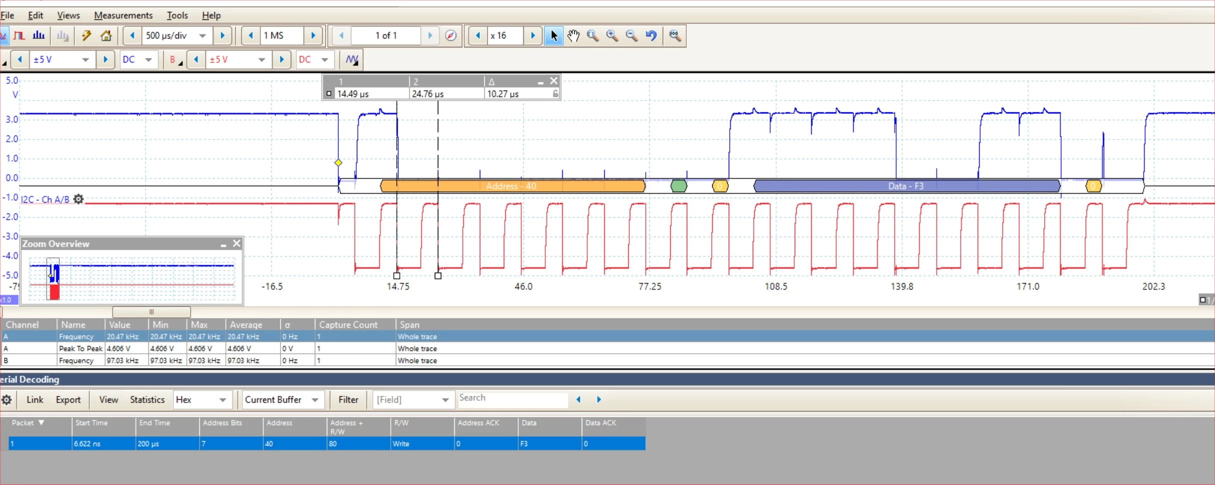

Peter Mather
Jan 10, 2019 2:59 PM UTC
Thanks for the suggestion. Adding delay makes it work BUT only when the scope is connected to SCL!
It looks like there is something funny about STM32L432KC (32-pin) and also the DHTU21 (a poor I2C implementation?) and together....
I can replicate the problem both on the Nucleo and on a breadboarded STM32L432KC
Interesting on the new scope trace is that while I2C_TIMINGR.SDADEL affects the change of SDA after clocks 0-6 it does not change the timing of clock 7 when SDA is released immediately on the downgoing edge of the ACK/NAK clock pulse
UPDATE fixed by adding 56pF between SDA and GND - I think the issue is the very fast release of SDA after the last clock
waclawek.jan
waclawek.janBest answer
Jan 10, 2019 3:04 PM UTC
Sounds like crosstalk between SDA/SCL, and/or grounding problem.
If pin speed in GPIOx_OSPEEDR is set to high, set it to lower/lowest.
Peter Mather
Jan 10, 2019 3:28 PM UTC
Set to very_high by CubeMX changed to LOW and now working without the added capacitance - many thanks
