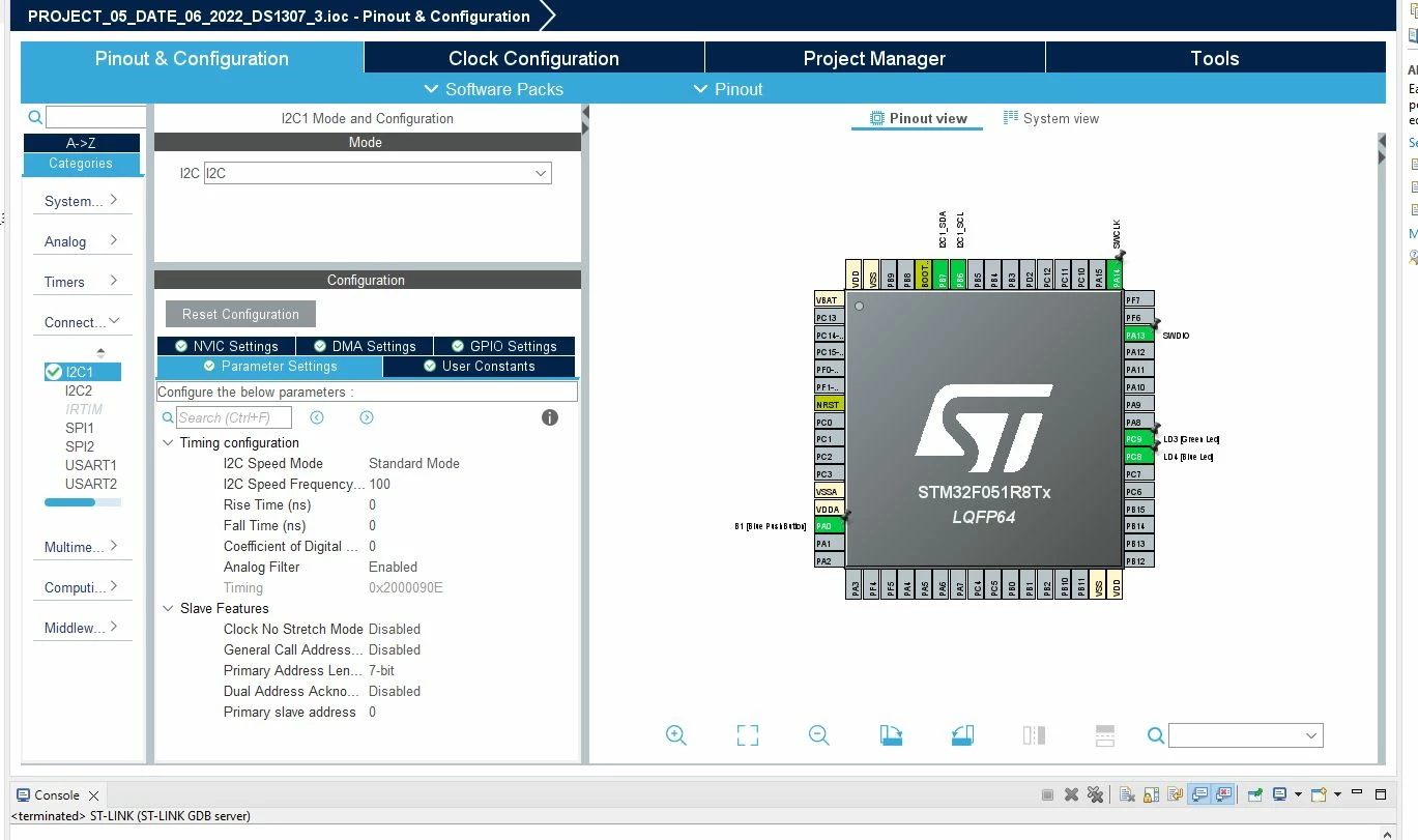

1 . I set configuration:
0693W00000NspqmQAB.jpg2 . Generate the code via Cube.

and LED connected to SQW output of DS1307 is still blinking after uplode code to STM32F0 Discovery. What I do wrong?

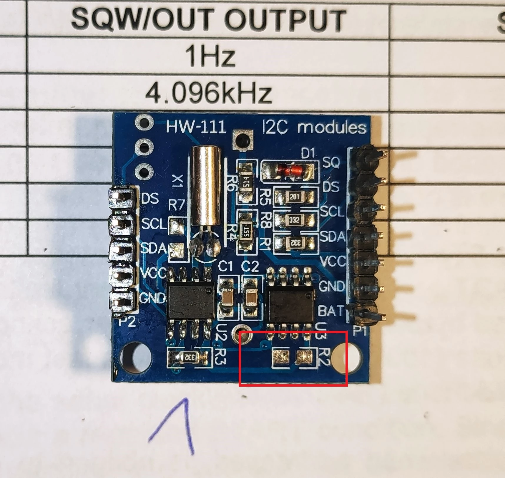

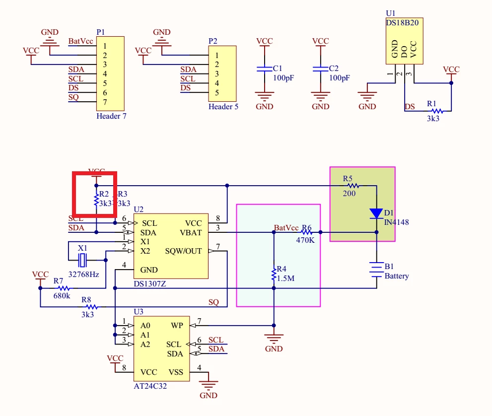

Oh, for bats's snacks, it was the pull-up resistors. It cost me a few days :-(. One thing to note - Arduino works well with the module, STM does not :-(.

@PReka.2​  "it was the pull-up resistors"
That would have been immediately obvious with an oscilloscope (or logic analyser).
When working at this level, the hardware is a key part of the system - you need hardware tools as well as software tools!
"Arduino works well with the module, STM does not"
Presumably because Arduino provides pullups?

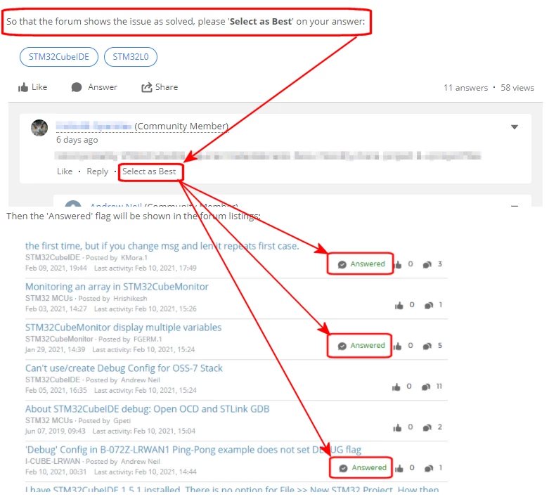

  3. Thanks for showing the steps to marking the solution. I will close it after answers about I2C and internal pullups.

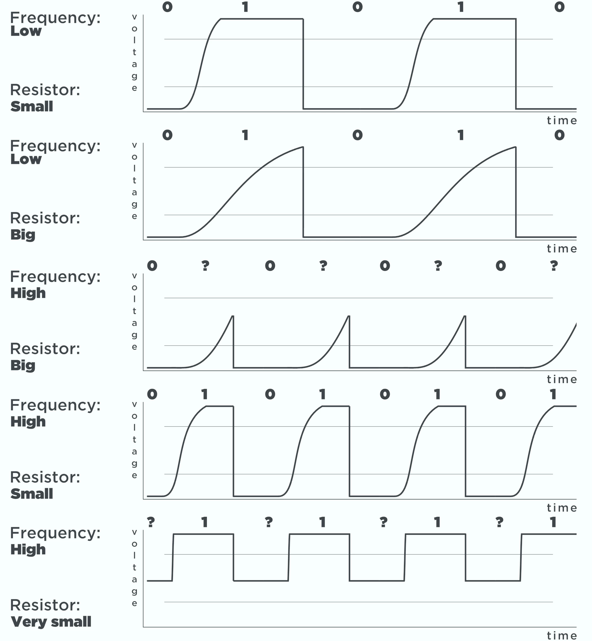

@PReka.2​  "Is it ok to use inernal pullups to I2C communications?"
As noted earlier, they will generally be too weak - but you might "get away" with it ...
A thread on I2C pullups:
https://electronics.stackexchange.com/questions/1849/is-there-a-correct-resistance-value-for-i2c-pull-up-resistors
In that thread, this picture shows the effects of the pullup value:
Note that marking a solution doesn't close the thread - further replies can still be added.
