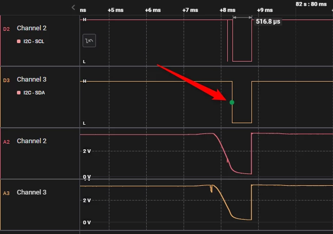

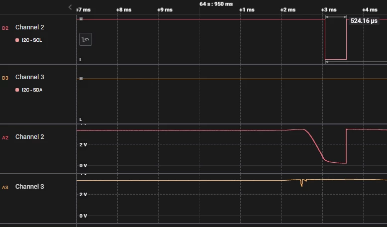

The SCL isn't pulled low indefinitely by fan controller. It's only a voltage spike on the line which makes this problem.
I attached two useful images. They are captured by a logic analyzer.

Looking at the analog trace, I see those lines are going down fairly slowly. That makes me wonder if your fan-controller isn't actually driving them low. But rather it is failing to pull them up. And other things (e.g. your 'scope probe) are pulling them down.
Do you have other pull-up resistors for SCL, SDA in the system? If so, what value are they?
