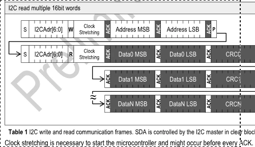

SCD_30 interface description attached

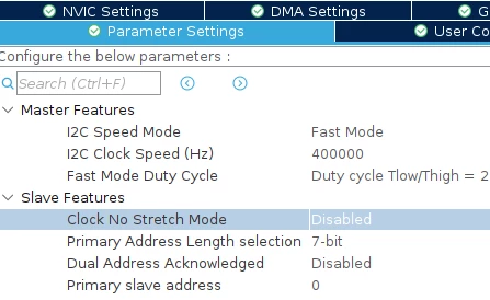

>it just hangs after the first I2Cwrite.
from SCD_30 ds can see, sensor need clock-stretching after first write. ->
so: you have clock-stretching enabled ?
0693W00000WJ2EaQAL.pngin Cube ->
0693W00000WJ2DrQAL.pngand adress is ok ? 7-bit , need shift left in HAL calls.
