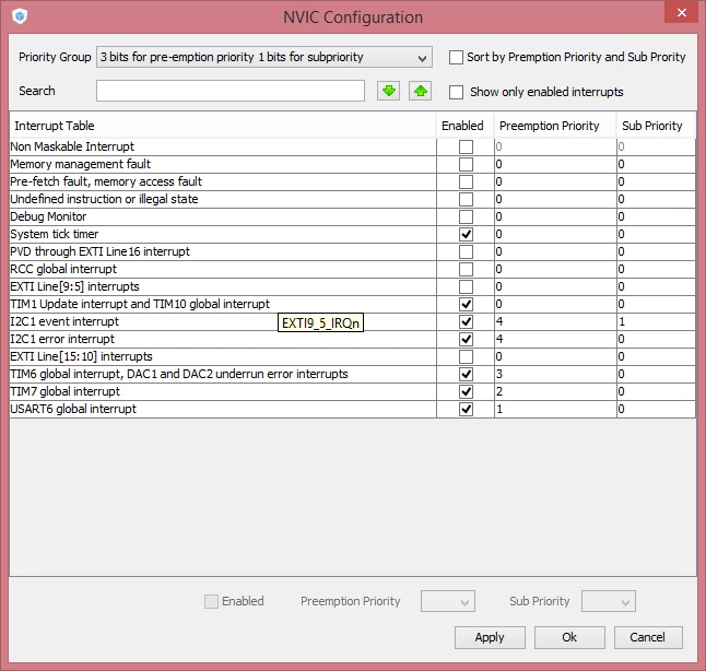

Hi there,
I'm trying to do a blocking I2C read in another interrupt. If I receive a NAK the HAL seems to crash (I'm seeing
uwTick
stop). Both the I2C interrupt and the interrupt I'm doing the read from have a lower (higher numerically) priority than the system tick timer.
Does anyone know why this could be happening?
Thanks!
Ben
