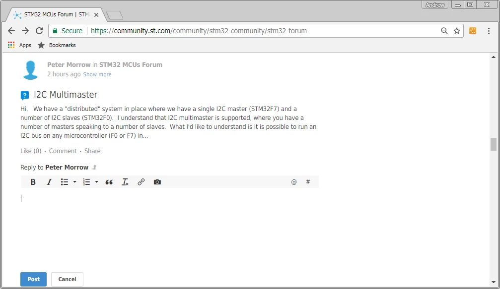

    Because of the forum shambles, I can't see the whole of the question:
    Hopefully, this will make it appear in my 'inbox' view ...
