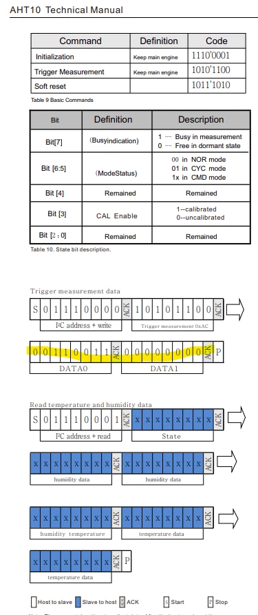

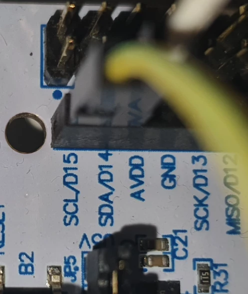

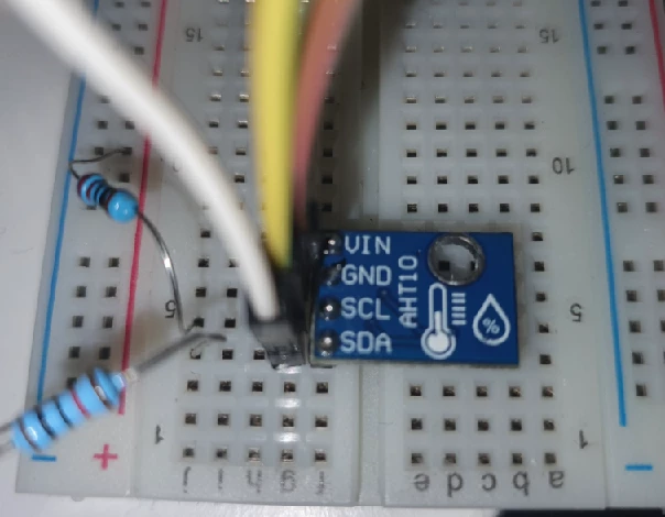

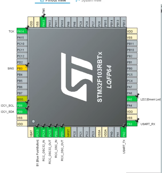

From my research, it seems the AHT10 sensor is on address 0x38. I have attached from what I think is the datasheet for the AHT10 as well as a couple pictures of my setup as well as my .ioc file.
I'm a hobbiest and don't have anyone to turn to, please help.
My AHT10 sensor with the 2 pull up resistors (both connected to positive rail
The 2 wires connecting back to my nucleo board.
Image of my .ioc file
I have attached the AHT10 datasheet (i could be wrong but this is what i found).

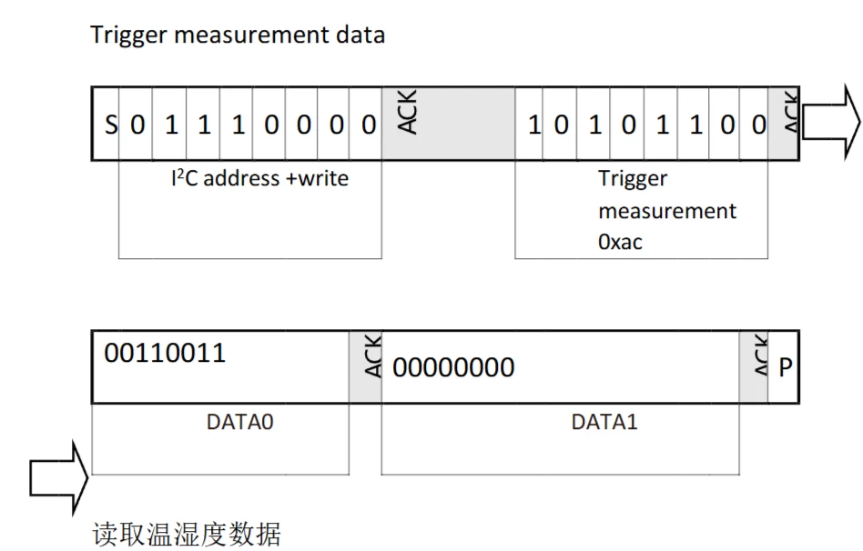

> ret = HAL_I2C_Master_Transmit(&hi2c1, 112, buf, 8, 10000); //Returns HAL_ERROR
Looks like the device is only expecting 3 bytes for this command (0xAC, DATA0, DATA1), but you're sending 8. It's probably NACKing on the unexpected bytes. Why are you sending 8? Or am I misreading the data sheet?

It's not very clear, but it looks like the trigger data needs to be 0x33, 0x00.
#define AHT10_SLAVE_ADDRESS (0x38 << 1)
#define TRIGGER_MEASUREMENT 0xAC
uint8_t aht10_data[6] = {0};
// update for Trigger measurement
aht10_data[0] = TRIGGER_MEASUREMENT;
aht10_data[1] = 0x33;
aht10_data[2] = 0x00;
// send trigger measurement byte plus 2 bytes
HAL_I2C_Master_Transmit(&hi2c1, AHT10_SLAVE_ADDRESS, aht10_data, 3, 100);
// Datasheet indicates MCU must wait for the measurement to be completed.
HAL_Delay(100);
// read temperature and humidity data, 6 bytes
HAL_I2C_Master_Receive(&hi2c1, AHT10_SLAVE_ADDRESS, aht10_data, 6, 100);
