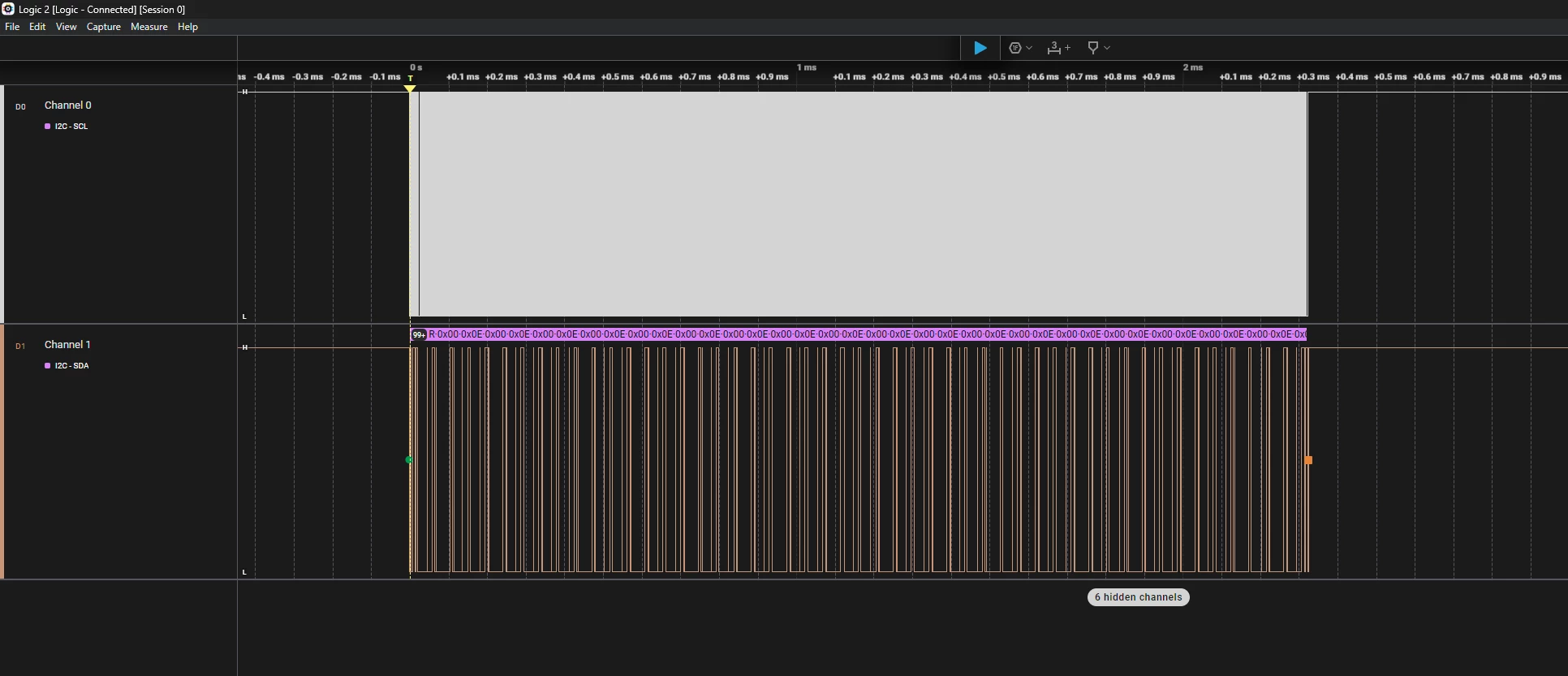

NMan.11
NMan.11Author
October 21, 2024
Hi @Ghofrane GSOURI
Thank you for the quick response.
Now as far as hardware and clock configuration go, they are all fine. I've checked the I2C fronts with a scope and they are steep enough to be read properly. I'm sorry i don't have a capture of the signal.
I've also using this hardware (pull-up resistors and I2C settings), I'm just retriggering the DMA transfer every time its done, so I'm imitating the circular DMA logic as well as it is possible.
I2C_ADDRESS_ADC is actually already shifter.
Yes i agree about the buffer size, this was just a simple sanity check code and i was using to quickly test everything and i was noodling.
Unfortunately changing the data alignment, didn't fix the original issue. It just triggers the transfer once and stops. It's acting like normal mode basically.
