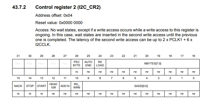

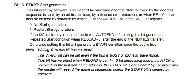

    Hi
    The STM32L4 Series and STM32L4+ Series devices implement a different I2C peripheral
    • The user must set the START bit in I2C_CR2 register
    please tell me how i need to proceed for I2C Start, on which control registers i need to take which has both START and RESET
    • The START bit is reset by hardware when the slave address has been sent on the bus, whatever the received acknowledge value. The START bit is also reset by hardware if an arbitration loss occurs

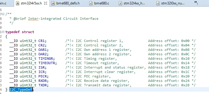

    Hi Nesrine
    Board: Nucleo144- STM32L4R5ZI.
    I want to write I2C_start condition .
    Use case: Read/write sensor BME680 over I2C.
    Please tell me what are the equivalent for
    I2C_GenerateSTART as in case of STM32FXX series.
    In Case CR1 series i cannot find
    I2C_CR1_START and for RESET i find I2C_CR1_SWRST  Case CR1:  START :: NO RESET :: YES
    But i cant find for CR2 for STM32L4XX series.  The above explain is for Start condition of I2C as like this :   Case CR2::  START :: YES  RESET :: NO
    D_LOG(''Generate start condition\n''); dev->CR2 |= I2C_CR2_START; // This will make start of I2C on CR2.   For CR2 its not available. i want to know why there is not there for CR2(control register 2). 0690X0000060KvTQAU.png
    Thanks
    Phaniraj

    Hi

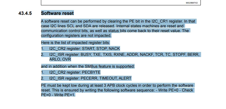

    Phanirajkiran M
    Senior
    May 24, 2018 1:36 PM UTC
    Posted on May 24, 2018 at 15:36
    Thanks for the support Nesrine.
    Yes for SWRESET
    On I2C_CR1 bit 13
    Thanks
    Phaniraj
