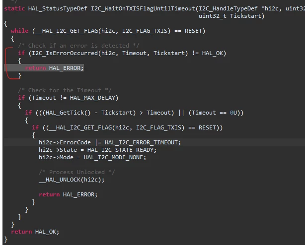

I've had this error :
I don't know if this Timeout is because the I2C didn't receive the ACK bit ?

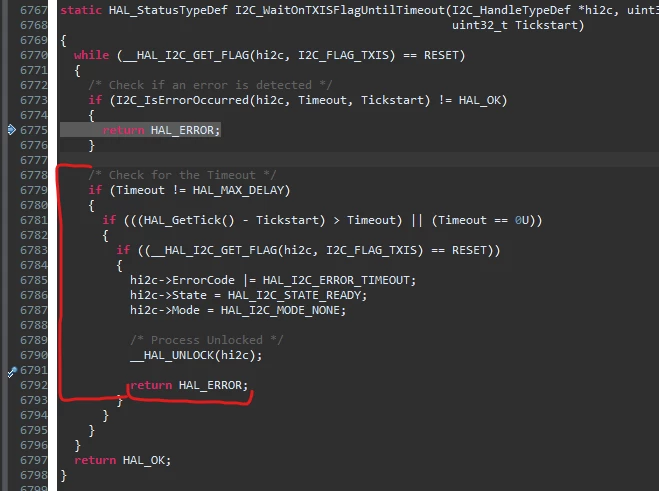

But when I've added the pull up resistors :
The error was then this part :
I don't really much know what happened though.

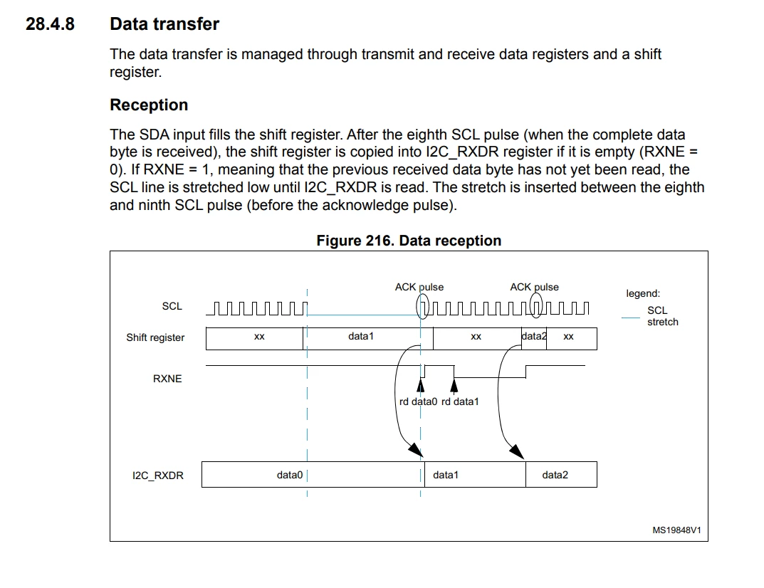

In RM for STM32 Nucleo-L073RZ I found this :
I don't know if I2C_RXDR is the ACK bit that Master is now an input and waits for this ACK/I2C_RXDR ? Maybe but this stretch was maybe a timeout ?
I got a bit confused. Is master receiving more data through SDA (or maybe SLC although it is only a clock), not just only Start, Stop, ACK and data ?
Also the Transmission is different because it stretches the clock after ACK and Receiver before ACK, weird, somebody knows why ?
