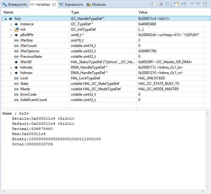

I2C endless loop in HAL_I2C_GetState
Posted on January 18, 2017 at 16:20
im using a STM32L476RG and want to interace an extrenal RTC via I2C.
cube = 4.19.0
lib L4 = 1.6.0
hi2c1.Instance = I2C1;
hi2c1.Init.Timing = 0x10909CEC;
hi2c1.Init.OwnAddress1 = 0;
hi2c1.Init.AddressingMode = I2C_ADDRESSINGMODE_7BIT;
hi2c1.Init.DualAddressMode = I2C_DUALADDRESS_DISABLE;
hi2c1.Init.OwnAddress2 = 0;
hi2c1.Init.OwnAddress2Masks = I2C_OA2_NOMASK;
hi2c1.Init.GeneralCallMode = I2C_GENERALCALL_DISABLE;
hi2c1.Init.NoStretchMode = I2C_NOSTRETCH_DISABLE;
/**I2C1 GPIO Configuration
PB6 ------> I2C1_SCL
PB7 ------> I2C1_SDA
GPIO_InitStruct.Pin = GPIO_PIN_6|GPIO_PIN_7;
GPIO_InitStruct.Mode = GPIO_MODE_AF_OD;
GPIO_InitStruct.Pull = GPIO_PULLUP;
GPIO_InitStruct.Speed = GPIO_SPEED_FREQ_VERY_HIGH;
GPIO_InitStruct.Alternate = GPIO_AF4_I2C1;
HAL_GPIO_Init(GPIOB, &GPIO_InitStruct);
/* Peripheral clock enable */
__HAL_RCC_I2C1_CLK_ENABLE();
/* Peripheral DMA init*/
hdma_i2c1_rx.Instance = DMA1_Channel7;
hdma_i2c1_rx.Init.Request = DMA_REQUEST_3;
hdma_i2c1_rx.Init.Direction = DMA_PERIPH_TO_MEMORY;
hdma_i2c1_rx.Init.PeriphInc = DMA_PINC_DISABLE;
hdma_i2c1_rx.Init.MemInc = DMA_MINC_ENABLE;
hdma_i2c1_rx.Init.PeriphDataAlignment = DMA_PDATAALIGN_BYTE;
hdma_i2c1_rx.Init.MemDataAlignment = DMA_MDATAALIGN_BYTE;
hdma_i2c1_rx.Init.Mode = DMA_NORMAL;
hdma_i2c1_rx.Init.Priority = DMA_PRIORITY_LOW;
if (HAL_DMA_Init(&hdma_i2c1_rx) != HAL_OK)
Error_Handler();
__HAL_LINKDMA(i2cHandle,hdmarx,hdma_i2c1_rx);
hdma_i2c1_tx.Instance = DMA1_Channel6;
hdma_i2c1_tx.Init.Request = DMA_REQUEST_3;
hdma_i2c1_tx.Init.Direction = DMA_MEMORY_TO_PERIPH;
hdma_i2c1_tx.Init.PeriphInc = DMA_PINC_DISABLE;
hdma_i2c1_tx.Init.MemInc = DMA_MINC_ENABLE;
hdma_i2c1_tx.Init.PeriphDataAlignment = DMA_PDATAALIGN_BYTE;
hdma_i2c1_tx.Init.MemDataAlignment = DMA_MDATAALIGN_BYTE;
hdma_i2c1_tx.Init.Mode = DMA_NORMAL;
hdma_i2c1_tx.Init.Priority = DMA_PRIORITY_LOW;
if (HAL_DMA_Init(&hdma_i2c1_tx) != HAL_OK)
Error_Handler();
__HAL_LINKDMA(i2cHandle,hdmatx,hdma_i2c1_tx);
Sourcecode:
while (HAL_I2C_GetState(&hi2c1) != HAL_I2C_STATE_READY){ }
if(HAL_I2C_Master_Transmit_DMA(&hi2c1, RTC_ADDRESS, (uint8_t*)txBuffer, TX_BUFFERSIZE)!= HAL_OK)
Error_Handler();
So I'm waiting until the bus is free. But after the first transmit, the HAL_I2C_GetState never get ready!
The logic analyser detects a ACK for the  RTC.
Could someone help me? I read a lot of forum sides, but do not found a concret solution for this problem.
regards
Roger

What's the content of hi2c1 and the I2C registers?
Roger Heil
Jan 19, 2017 9:32 AM UTC
Posted on January 19, 2017 at 09:32
I made a snapshot of the variable, when the system runnes inside the HAL_I2C_GetState.
regards Roger

And the interrupt handlers are set how?

When you use DMA with I2C to Transmit or Receive data,  you should
Enable I2Cx_ER_IRQn and I2Cx_EV_IRQn interrupts.
because they all called I2C_DMAXferCplt (hi2c->hdmarx->XferCpltCallback = I2C_DMAXferCplt)
and it  enable interrupt call to handle I2C state.
  __HAL_I2C_ENABLE_IT(hi2c, I2C_IT_EVT | I2C_IT_ERR);
Roger Heil
Jan 20, 2017 8:36 AM UTC
Posted on January 20, 2017 at 08:36
when I insert into i2c.c the lines
HAL_NVIC_SetPriority(I2C1_ER_IRQn, 0, 0);
HAL_NVIC_EnableIRQ(I2C1_ER_IRQn);
HAL_NVIC_SetPriority(I2C1_EV_IRQn, 0, 0);
HAL_NVIC_EnableIRQ(I2C1_EV_IRQn);
the system runnes into this Assember line
WWDG_IRQHandler:
080137b0: b.n 0x80137b0 <WWDG_IRQHandler>
