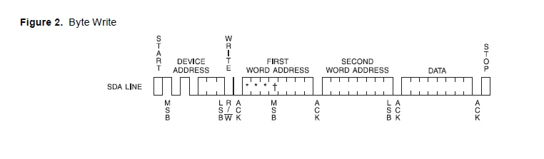

Hello friends
I want to using the functions HAL To connect with AT24C64
To Byte Write & Byte Read How can I send data as below:
I've searched but did not find the answer
Thank

instead of using address 0xA0 use the address (uint16_t)(0x50<<1) as the HAL wants the address left aligned
