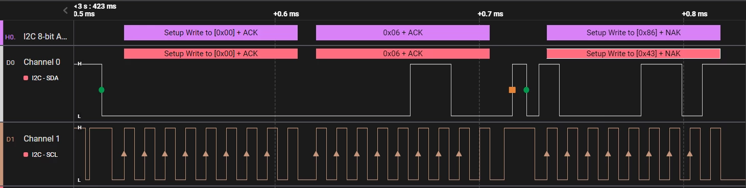

I2C_DR register wont be cleared
I'm using stm32f103c8 and PCA9685 devices. I'm trying to send data to PCA9685 via I2C bus. I send data using I2C_DR register. But when i write a data to I2C_DR register it sticks to it. After the data is send thee I2C_DR register should be cleared but it wont happen in my code. I have no idea why this is happening. This is what i see in logic analyzer.

void I2C_Write_Single(int device_address, int mem_address, int data)
	I2C1->CR1 |= I2C_CR1_START; //generate start condition
	while (!(I2C1->SR1 & I2C_SR1_SB)); // we check the SB flag if start bit didnt sent master device will stay in this loop
	I2C1->DR |= device_address ; // device adrees is 0x00
	while (!(I2C1->SR1 & I2C_SR1_ADDR)); // we check ADDR flag. Once there is address mach dvice will exit the loop
	temp = I2C1->SR1 | I2C1->SR2; // we need to cleear ADDR bit after we checked the flags. To reset SR1 and SR2 registers we just read them
	while (!(I2C1->SR1 & I2C_SR1_TXE)); // wait for the byte transfer
	I2C1->DR |= mem_address ; // MODE1 register (PCA9685 datasheet page 9)
	while (!(I2C1->SR1 & I2C_SR1_BTF));//wait for transmit
	I2C1->DR |= data << 1 ; // to set PWM frequeency we set SLEEP bit 1 (PCA9685 datasheet page 24)
	I2C1->CR1 |= I2C_CR1_STOP; //generate stop condition

It's a register, the act of writing it pushes values data into combinational logic and flip-flops internally. It's not designed to be used as a memory cell, or for you to RMW values into it
WHY???
Write the value I2C1->DR = data << 1

October 31, 2023
The problem is i used I2C1->DR |= .... It should be I2C1->DR = ....
